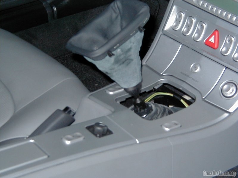

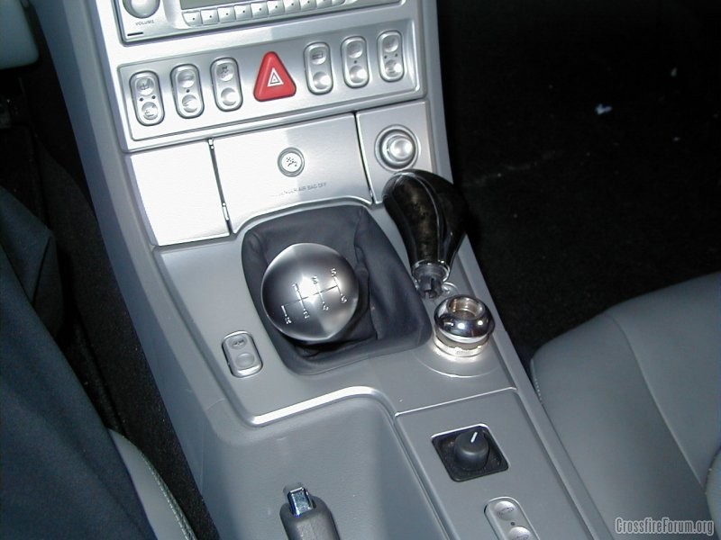

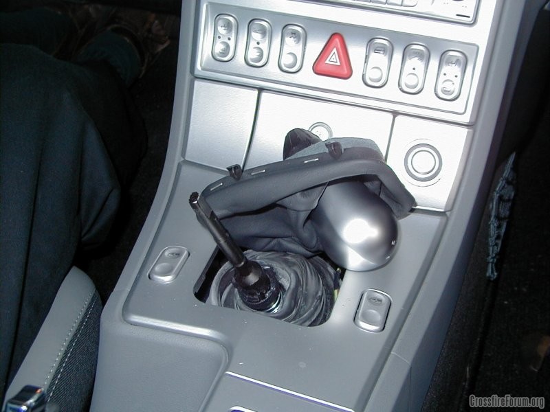

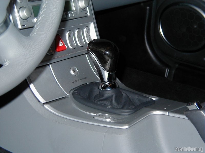

My new shift **** came today it took about 20 minutes to install.
Installation photos of Prestige Shift ****, Birdseye & Chrome Trim, Part # 26-052.
I placed the order to fit a 2002 SLK230 from PerformanceProducts4Benz.com.
http://www.performanceproducts4benz.com/productpage.aspx?pid=110602&name=Prestige+Shift+Kn obs
$142 + $18.95 = $160.95
This shift **** is a nice improvement!
No Instructions come with the ****, here's what I did.
  1. Squeeze boot base and lift up.
  2. Unscrew gear shift retainer under the boot.
  3. Pull up to remove shift **** and remove boot from ****.
  4. Place new retainers on boot, then place on gear shaft.
  5. Press new **** on gear shaft. It should not turn if its on far enough.
  6. Screw on retainers and reset boot base.
Continued...
