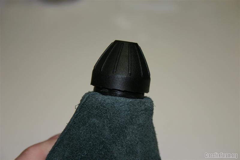

Once the leather boot is pulled up and the collar unscrewed then whole assembly comes out (this is the boot turned inside out, of course):

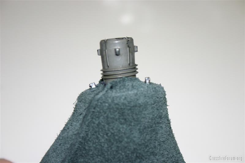

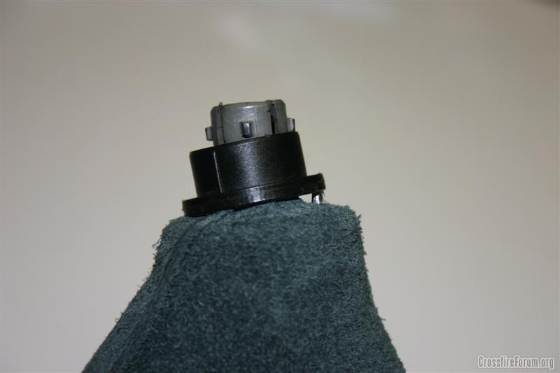

Remove the locking collar completely and you see another collar with two tabs through it and the leather, holding the boot to the shifter. Trying to just pull the boot off the **** at this point was stretching the leather around the holes and I didn't want to just keep pulling for fear of damaging the boot. Here is is pryed up on one side:
With the retaining collar pryed off you can clearly see the tabs protruding through the leather of the boot:

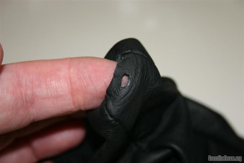

One of the pre-cut holes in the leather for the tabs to fit through:

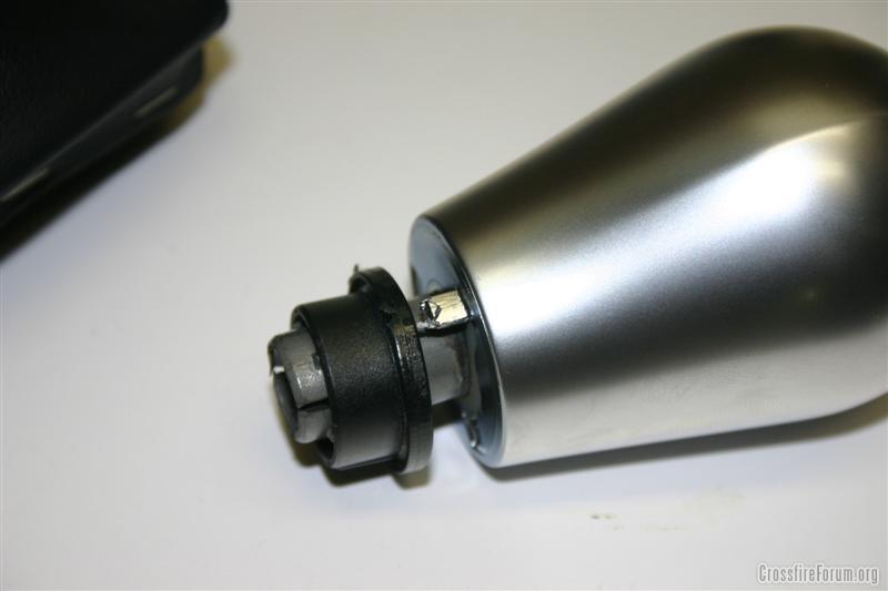

Finally, the bare **** with the locking collar back in place, sans leather boot of course. Here you can see the pins on the base of the **** and better understand how the top of the leather is then pinched between the base of the **** and the locking collar. These did not want to separate simply by pulling firmly on the **** - that's when the leather was coming under abuse I wasn't willing to give it.

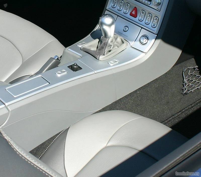

Me, I just took some Aero Blue touch up paint and a very fine artists brush and painted the recessed numbers and extended "H" pattern in the stock ****. I like all the matching silver trim on the car as is. One thing I did change, however, was the shift boot - hence my reason for this post in the first place. Instead of the plain black boot, I now have a two tone boot that perfectly matches my two tone seats. Unfortunately, this image doesn't show the blue in the numbers, but my shift boot is the hotness.
