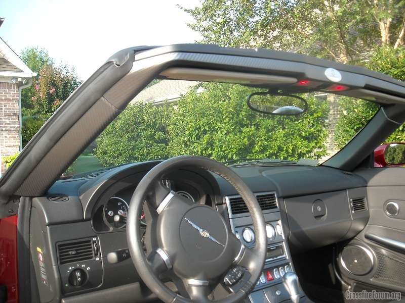

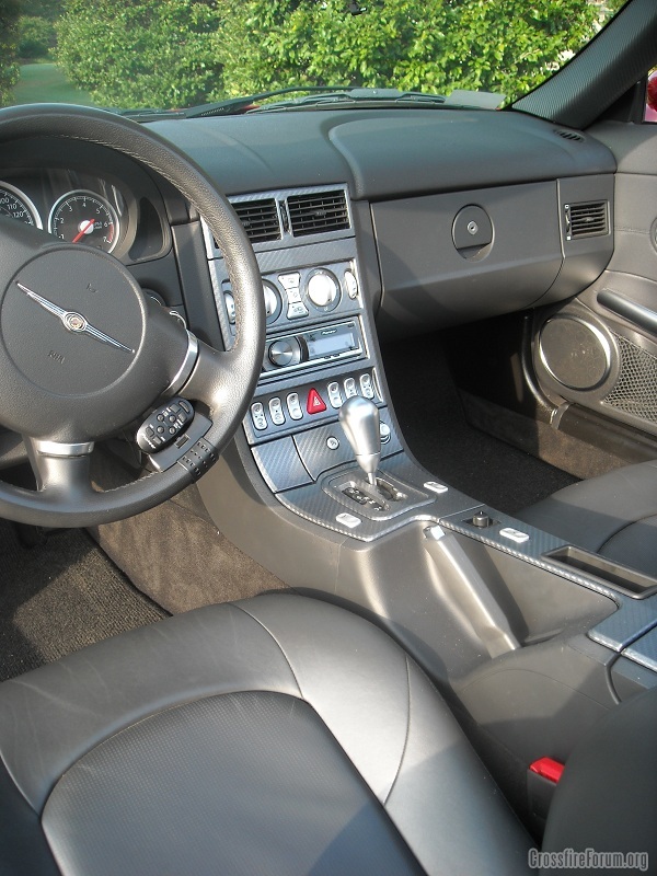

Max, that looks absolutely awesome. So, you were able to wrap to the inside of the vents and the vent louvers still work? That was my only issue with the neffy wrap. I may have to do this sometime this fall after it cools down a bit.

Thanks, guys. Yes, everything works fine. Make sure to take the time to take everything apart. Makes it much easier in the long run. Just PM me if you need any pointers.

VERY nice Max!. It seams to have a blue tint in the photos. Is it like that in person?
None. It must be the reflection of the pretty blue sky we had this morning. It's actually a bit darker graphite than shows in the pictures. Makes a really nice 3-tone with the charcoal and silver buttons.

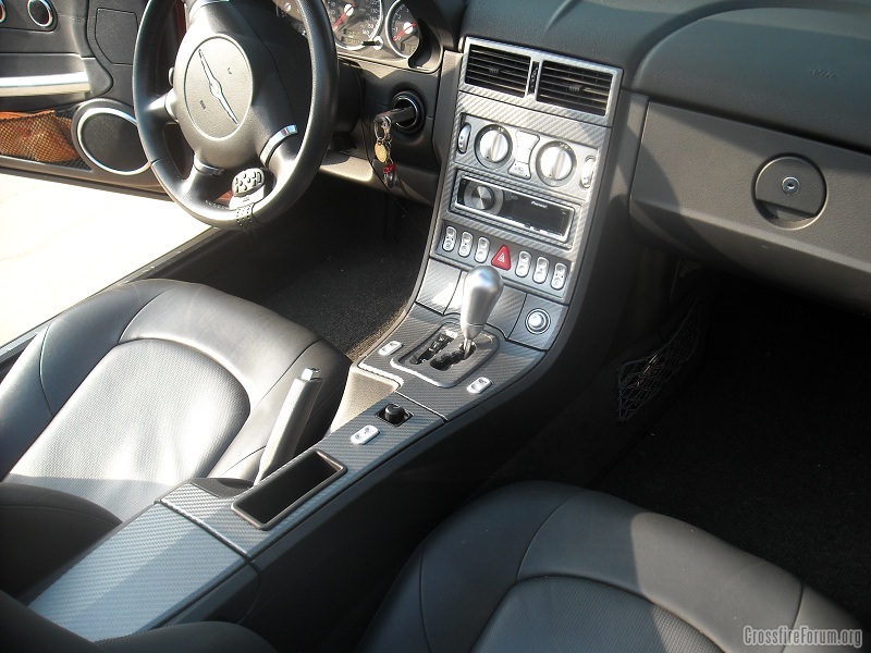

Man that looks GREAT Max! What color did you use? Any tips on getting the "grain" lines to match up on all the console pieces? Awesome job!
Thanks!
Keep in mind that the color, in person, is darker than the photo. Bright day-cheap camera.
I used "Graphite". The 3M material comes on a paper backing that is laid out in grid lines. When I started, I traced the shapes with a Sharpie on the backing, keeping in mind "UP".
The pattern is the same "UP" and "DOWN". Meaning, if you flip a piece over to "DOWN"-it looks exactly the same.
