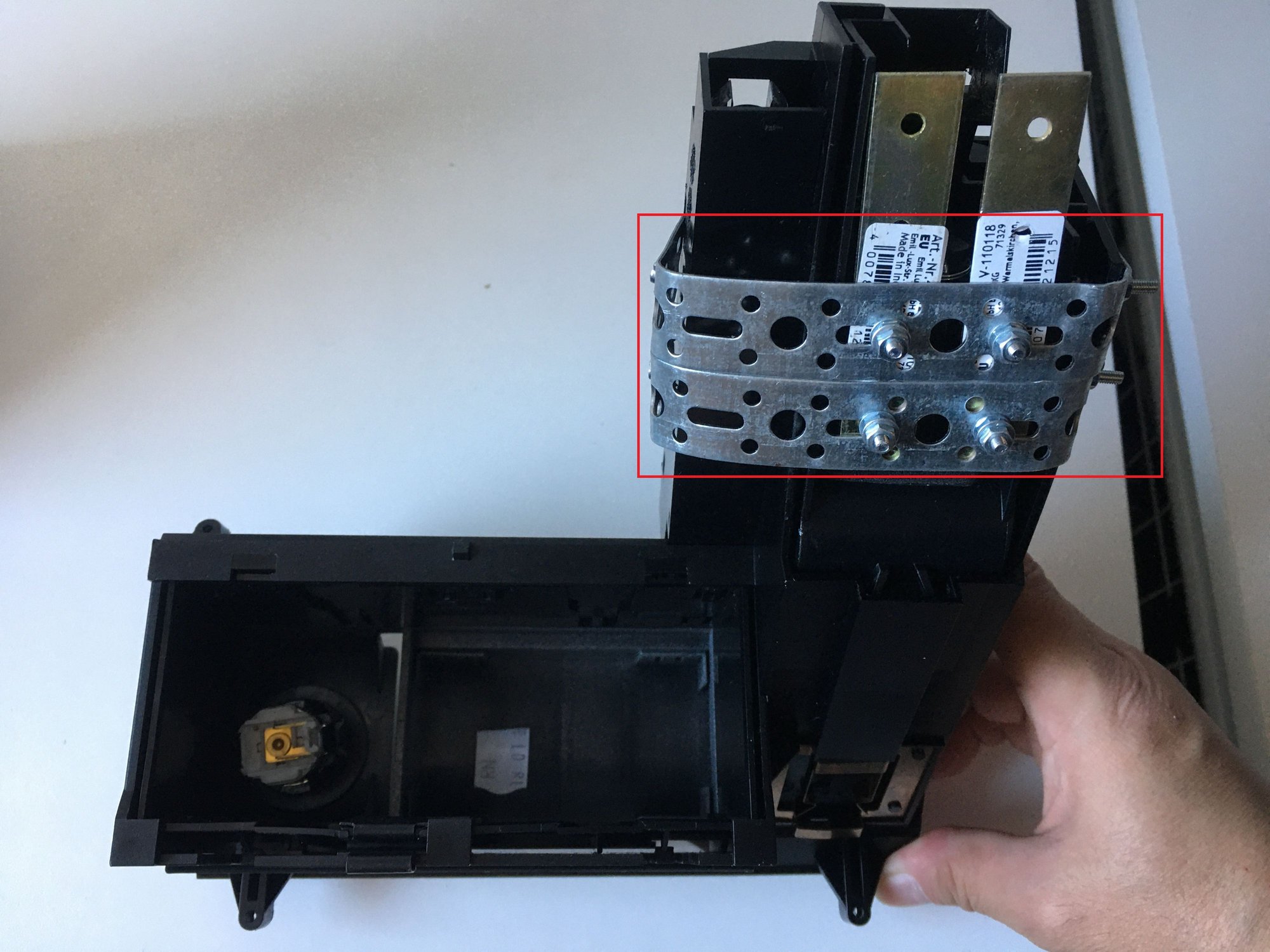

I had the 'same' issue with one of my Crossfires in which, unfortunately, the 'hook' mechanism for the Ashtray broke, thus, the 'repair' as already posted in this Thread was my best course of action. I took some pictures of my process as it may help with regard of the pieces of the Ashtray unit. My main concern was whether or not the 'middle' piece where the airbag light is on for the US Crossfire Versions as well as the cigarette lighter could be 'transfered' to a 'new' (though used) replacement unit that may or may not have those pieces in the set. These pictures will definitely help those users to clear those questions:
(If you can't see the pictures, then you may need to be logged on in the forum first. The pictures are in full size as I wanted to post as much detail as possible... as in my case, when researching this issue, I stummbled upon this thread, in within other postings as well, and used every bit of information to determine which way, if any possible, could be the best course of action to 'repair' my Ahstray Assembly for the Crossfire)
Chrysler Crossfire Ashtray
Chrysler Crossfire Ashtray - Detail

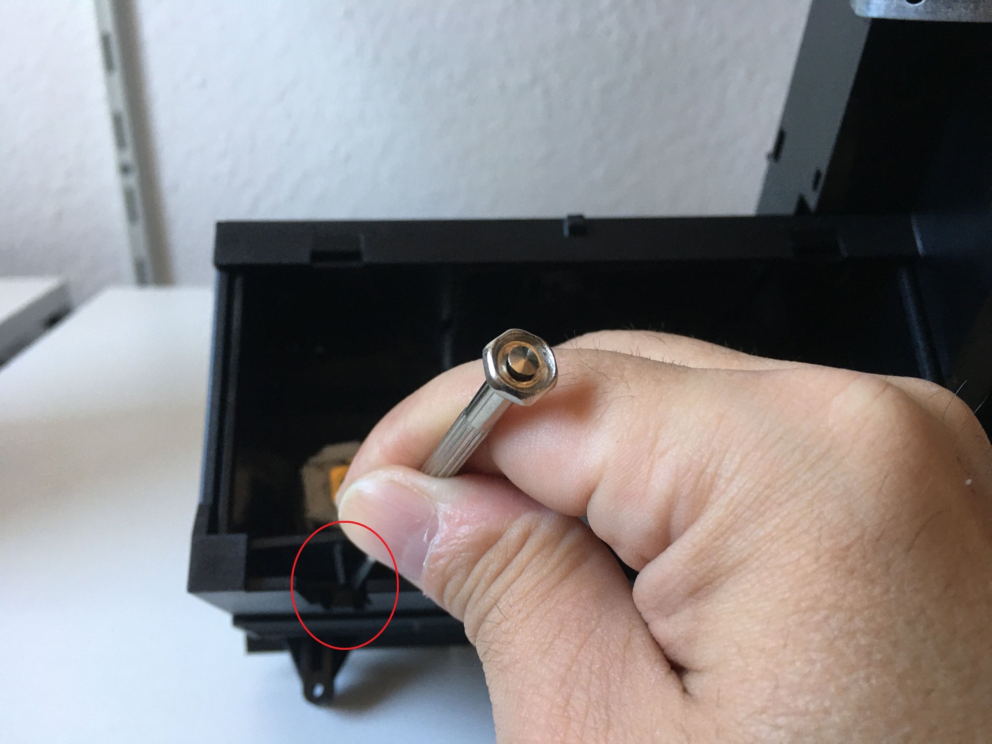

Once the 'middle' section and Cigarette lighter assembly unit has been removed, then, if needed, it can be further disasambled:
-you can use a screw driver as seen in the pictures below to press down on the locking plastic clips found on the top and bottom to unlock it and be able to remove if from the frame that is mounted on
Repeat the same process on the bottom clips:
Once completed, then the entire front-end part that hold the 'middle' piece/plate (where the Airbag light is for US Crossfires) and the Cigarette Lighter will be removed

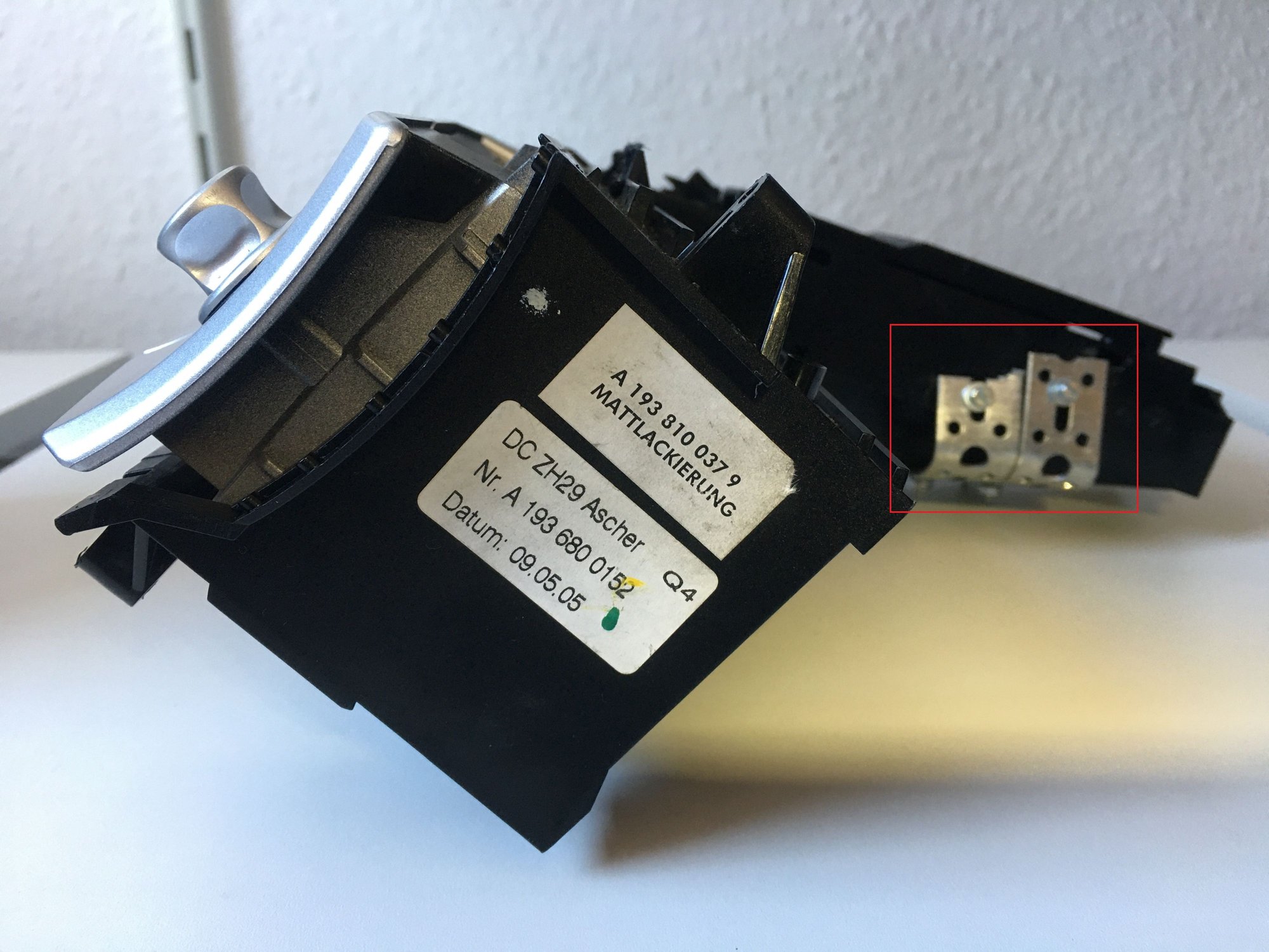

The pictures below shows the Ashtray Unit fully disasambled:
In my case, I was able to find an entire Ashtray Assembly with a full working Ahstray (undamaged, fully functional) which included all the components as seen in the pictures above. What I ended up doing is removing the 'middle' section as shown in the pictures and 'transfer' the middle section (Middle Plate and Cigarette Lighter) from my existing vehicle into the 'replacement' part... mainly because I didn't want to risk to mount everything and find out the cigarette ligher didn't work. Though as anyone who can see the pictures above, the 'middle' section and cigarette lighter which in the pictures are 'after' I transfered, namely the Ashtray is the 'defective' part I already took out of my Crossfire and already had 'transplanted' the 'middle' section and cigaretted ligher from the 'replacement' (used) part into this unit. Though as you can see on the pictures, it look in tip-top shape.
Since I have a working Ashtray with middle section and cigarette lighter still from my existing Crossfire, I decided to do the 'repair' as Chuck had done before... the pictures show the 'end' result of a now 'spare' 'ready to go/ready to be installed' Ashtray Unit including the 'middle' section and cigarette lighter.
Just as in Chuck's video, I removed the 'coil' mechanism from the unit in the pictures above, so that the ashtray won't 'pop-out' (on this repaired unit) and installed the 'glassdoor' pin on the back of the unit, just as in Chuck's Video... so now, in case another one of my Crossfires had this problem, I have already another unit 'ready to go'.
(My Crossfires, all Coupes, 2007 Model Year --all of them-- I have owned since they were new... as of the time of this posting, all of them are in the 60k Kilometers (Aprox 37k Miles) since new.... so it is expected that after 10+ Years 'something' will break at some point... since the Ashtray Assembly unit is no longer available directly from Chrysler --or Daimler.. the Crossfire version... the R170 for the Mercedes Benz one is still available, though won't fit 100% as the front panels for the crossfire protrude a bit more than in the SLK R170--, than the repair as 'Chuck' described was the 'best' solution for me to get the 'old' unit repaired and store it as a spare part : )
