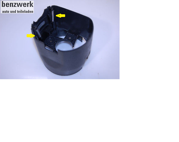

I have finally located the origin of the "Mystery Spring". It is one of two springs which belong to the plastic steering column cover adjacent to the steering wheel. Mercedes Benz Part #1704600395, Chrysler Part #05098991AA. (https://www.moparpartswebstore.com/p...5098991AA.html). These springs keep the small inspection door on the right side of the cover closed. These were really hiding well! Thank you to Marc Matherne for pointing me in the right direction.
