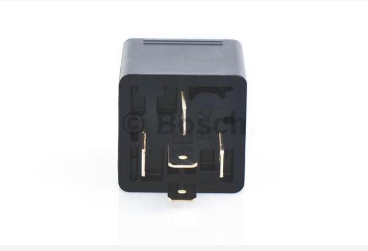

The car was made in Germany so I would imagine it is available over there. It does not have to be the same maker as these items are universally available and are made to the same specifications.
So would a multifunctional relay like this work?
Old Jun 14, 2019 | 05:24 PM
Likes: 647
Default Re: Both power seats not working
If it matched the specifications I guess it would, you have to match the specifications.
