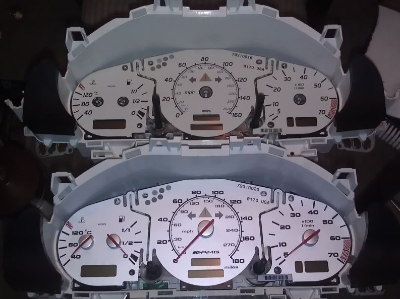

JHM2K changed his to white years ago, let me see if I can find his posts on it, it looked good.
He changed the whole panel to an AMG panel. But you can see what that looked like.
Someone else got the gas gage to work correctly, JHM2K never did, his car was totalled before he got that far. He was a great contributor here.

180 & ZERACER - If I get that far I will be glad to post my results. Thanks for the photo's, they look great. That exactly what I am wanting to do. My old eye's have a hard time making out the readings on the black face gauges. The white is so much easier for me.
