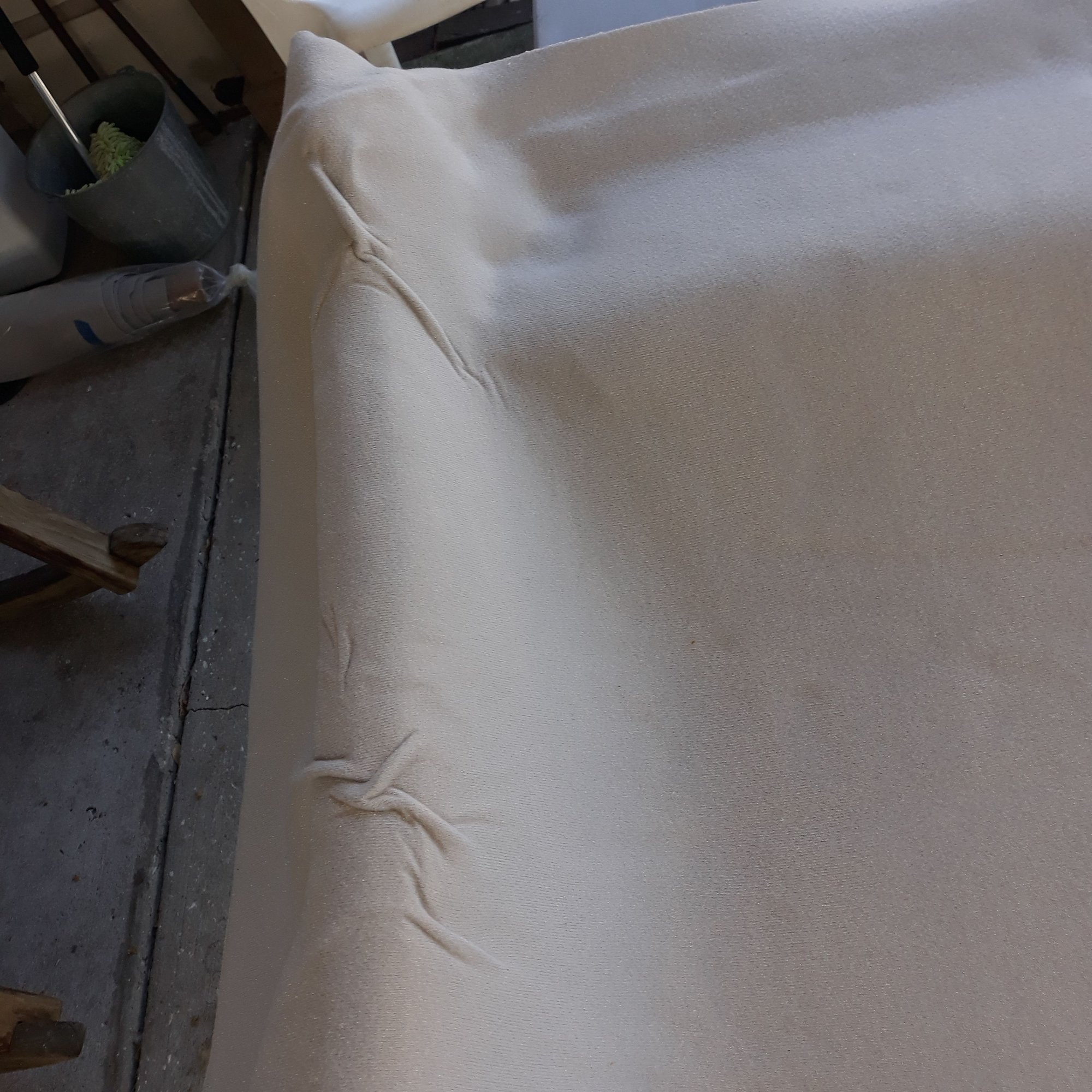

Now I've done it!! Started gluing the fabric on and screwed it up. Tried slicing and stretching and that didn't work. Guess I'm back to square one even though I tried going slow and easy but things didn't work out for me.

Default Re: Headliner fun has begun! (Sort of!)
When I get all the fabric mess off I think there may be a textured paint going back on! Maybe a tan or grey truck bed liner paint would be good. The headliner is giving me more anger than I want to endure. That spray adhesive is some tough stuff to work with especially if working it by yourself!

I removed all the fabric and foam. Ran out of Acetone so I'll have to finish up tomorrow to remove the adhesive. Because I've used Acetone some of the edges have started splitting form the base. I get some glue to strengthen back together. So far I've wasted about $65 of on materials. I will have it texture painted and back in the car by days end tomorrow.

As fresh as the adhesive is a heat gun may allow you to pull the fabric loose in that area. I would sure try that before giving up on the fabric install.
Sounds like a good idea and I'll give the heat gun a try on the fresh glue. Already ripped the fabric off and scraped the foam off with Acetone. Glued the two front corners back together.
Update: Just tried the heat gun and it does work except gets pretty hot on the hands when rolling off the glue. Gonna buy some lacquer thinner and see how that works.

I used lacquer thinners with terry towel (old face cloths) on an area of about 8"x8" worked best. It's slow and tedious work unfortunately. Good luck!

The Acetone worked a lot better than the Lacquer Thinner. I tried the heat gun once again and got a blister on both thumbs from trying to heat and roll the adhesive. Think I'll go back and buy another can of Acetone. I decided to use Rust-O-Leum tested paint instead of the truck bed liner. It's a light sandy texted feel and will use a primer underneath and clear coat over the paint. (Should I ever get this adhesive removed!)
