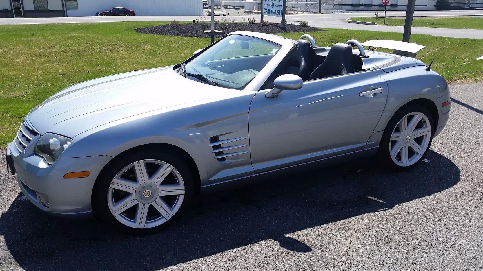

My Crossfire 2005 Roadster has been garage kept for the last 5 years.. and finally after (LIFE) is all we will say... I have her about to be back on the road. 5 years of sitting and it looks like only about $1300 of maintinece and she will be road worthy once more. I look forward to some connections on this slowly fading fun car but. Until She wont run I plan on enjoying it till the last days.
She needs some dash work, some love to the front bumper, new front billet grills, (stolen) but otherwise minor nicks and touch up I plan to do as much to condition it and keep it functional.
Any ideas are welcome!

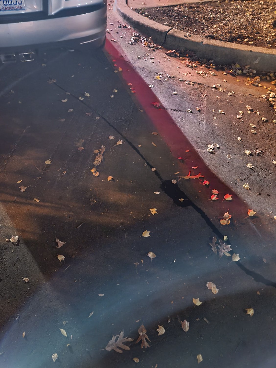

Update - So the shop, I am now wondering how good they really are with Mercedes based items.
1. Yes the car is in great shape.. (I arrive to pick it up, Top wont go down, No interior lights, No power seat functions, no trunk lights, the TPS is triggered, (no metal tubes in the tires), and the Radiator sensor is showing as well, (it was filled and flushed)
"We just cant find the issues.."
I found already 2 fuses that were part of that issues. then when we take it for a full test drive, while idling, (wife likes Pokemon Go) .. the car starts overheating and looks like we have a leak suddenly.
Very sad and disappointed, the owner of the shop has reached out to me and we will se where this goes.
"The radiator sensor is showing"? I'm sure you mean "the little light that looks like a radiator is on". This is not a "radiator light" it's "The General cooling system alarm light" and it comes on for the following reasons:
1) Coolant level is low. (rare)
2) Coolant level is fine, but level sensor is bad. (common)
3) Engine temperature is too high (the temp gauge will show this as well).
4) Then engine cooling fan motor is bad. (somewhat common)
5) The Fan Control module is bad. (somewhat common)
5) Probably other stuff we have not figured out yet. (but it's usually one of 1 to 5)
The fact you tell us the car is overheating AND this light is on, makes me think the fan motor is bad.
DO THIS:
With the car COLD, temp gauge at the bottom:
1) Start Car.
2) With outdoor air temp over 40F, turn climate fan to 1/2 speed or faster.
3) Press A/C button so it's little light comes on.
4) Pop hood, the engine cooling fan must be running slowly, it comes on with the A/C regardless of engine temp.
If the engine fan is not turning, you gotta fix that. You need a new 50 amp fan fuse or a new fan motor/blade assemble or a new Fan Controller.
Let us know what you find.
They are not competent, stop taking it to them.
See? You are fixing stuff they overlook. Stop taking the car to them.
Leaks are easy to fix, find where it is leaking and fix it. Keep in mind that overheating can cause leaks - so fix the overheating first.
