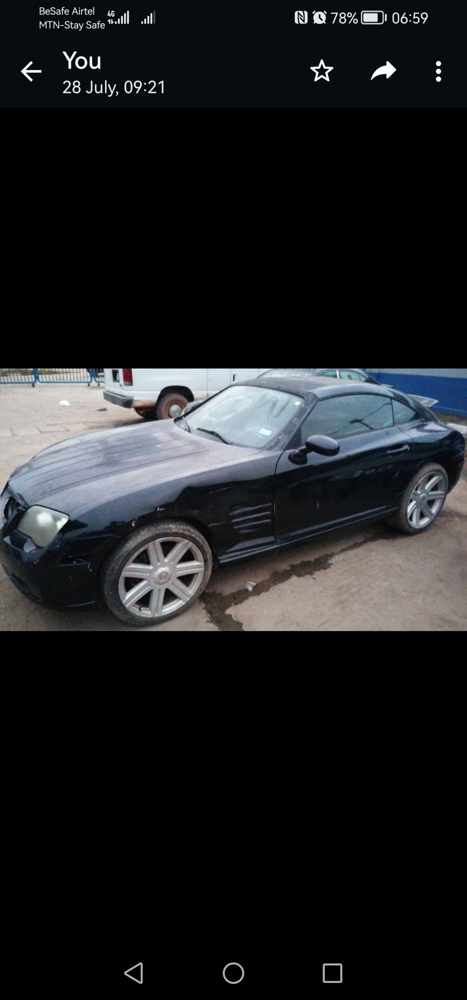

Hi everyone,
My name is Afeez, I just bought a chrysler crossfire 2006 model manual with this VIN number: 1C3AN59L36X061296 at NCS auction in Nigeria, unfortunately the car key had been stolen and there is no key for me to start the car. I've try to cut another key and get it program but the new didn't work out because it could not shock the engine to start even though all dash board light on but the car won't start.
Please kindly help me to get a solution to this problem so that I can enjoy my new crossfire.
Please I need the forum help to get this done.
