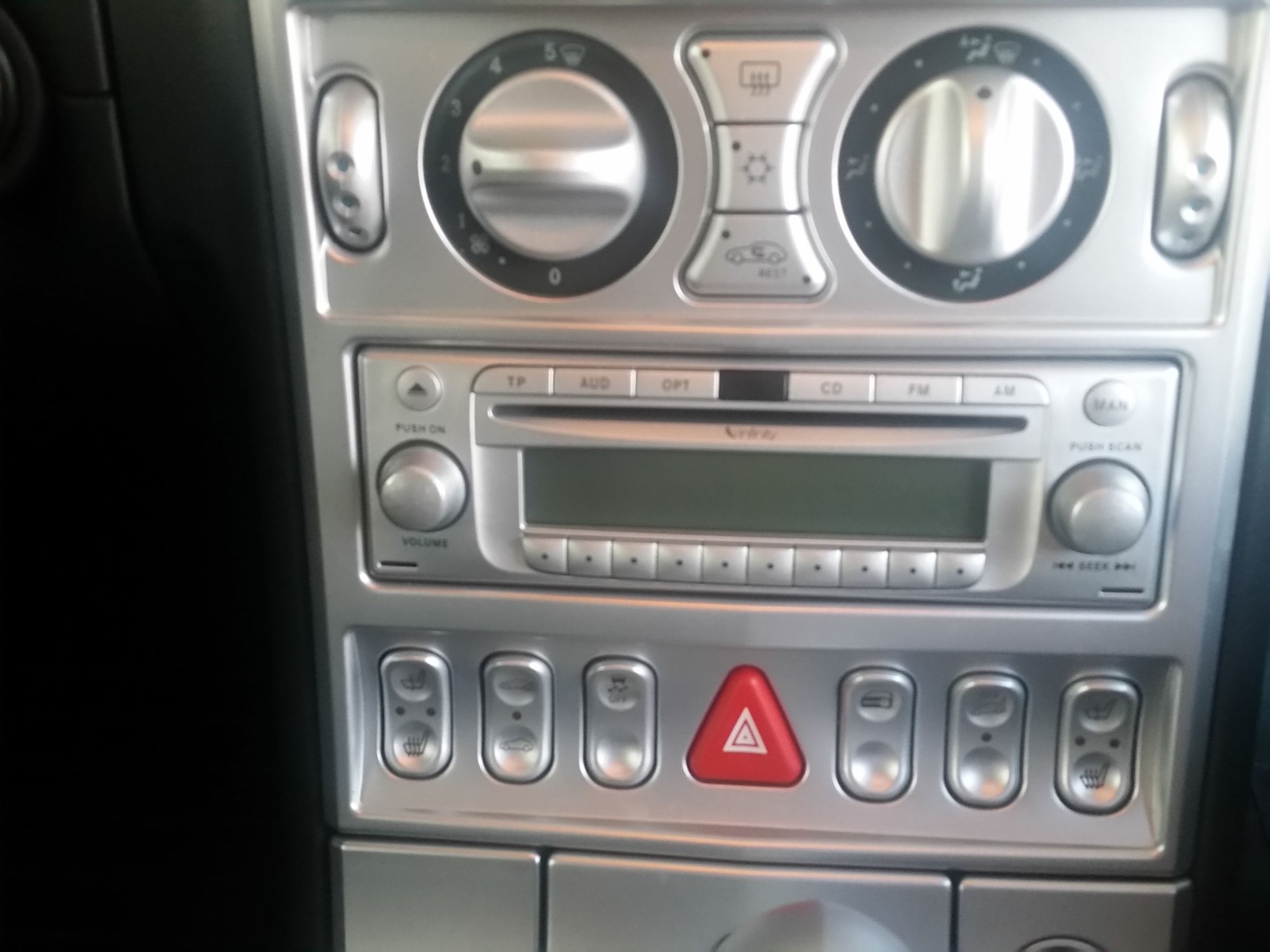

Originally Posted by ZERACER
The radio ***** can be repainted. Matching dyes for the interior are available also. Use the search feature at the top LH of the main page.
Gently pull the ***** off with a pair of pliers (I have a spring-loaded pair that applies only enough pressure to hold onto). I would recommend a 2-step repaint: 1) Spray both ***** with a Pain Adhesion compound so the paint will adhere to the plastic; 2) Then get a spray can of Chrysler Bright Silver for final coat.
Here's how mine turned out several years back:

Below is the Adhesion Promoter I bought from an O'Reilly's Auto Parts Store near me. They highly recommended it when I was getting ready to paint the plastic radio ***** on my Crossfire's radio.
