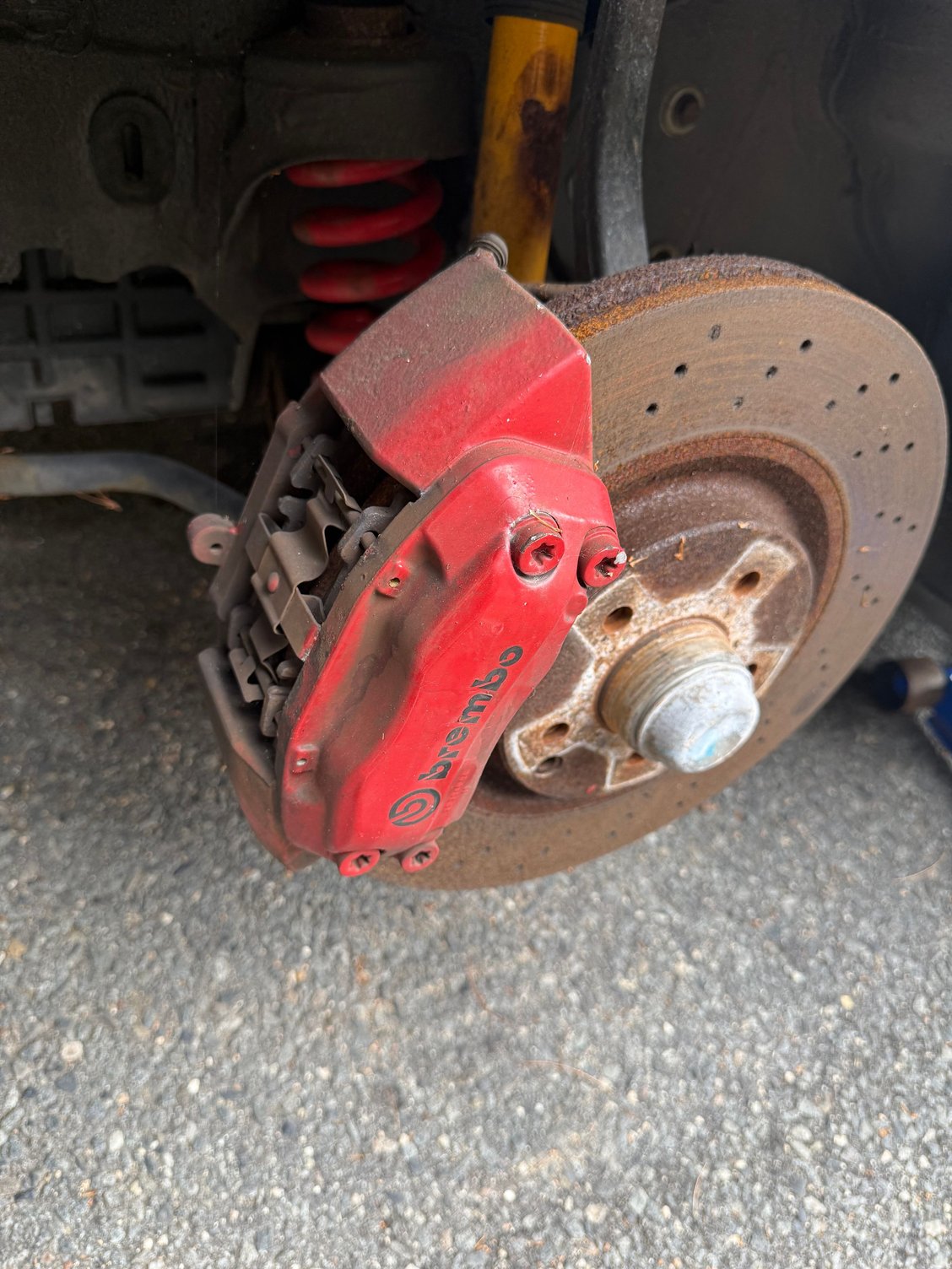

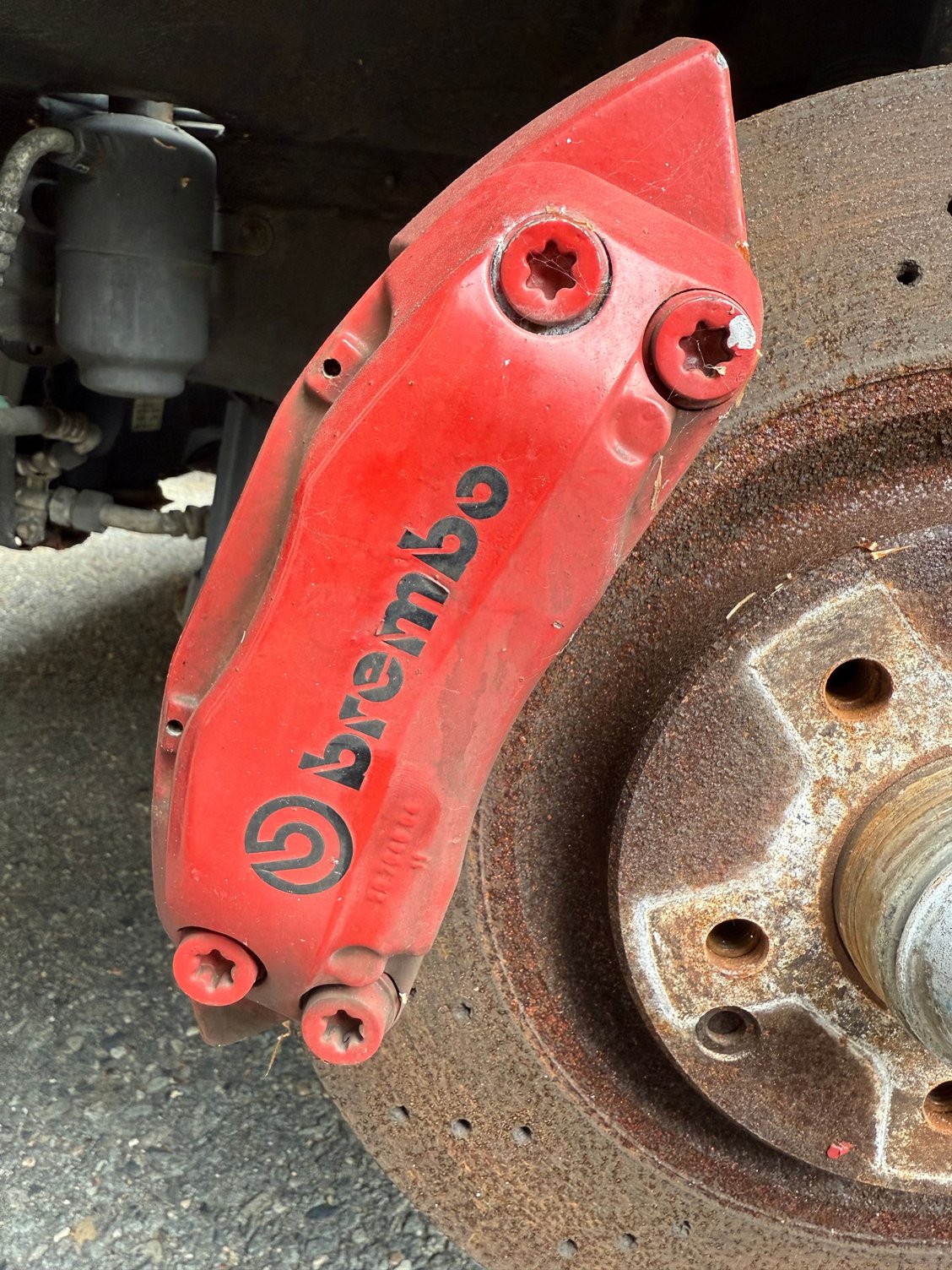

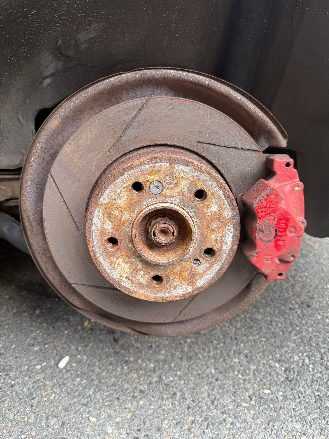

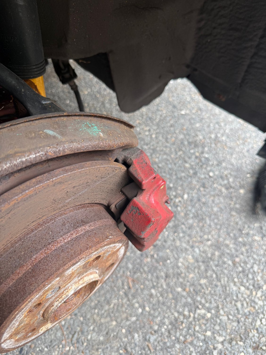

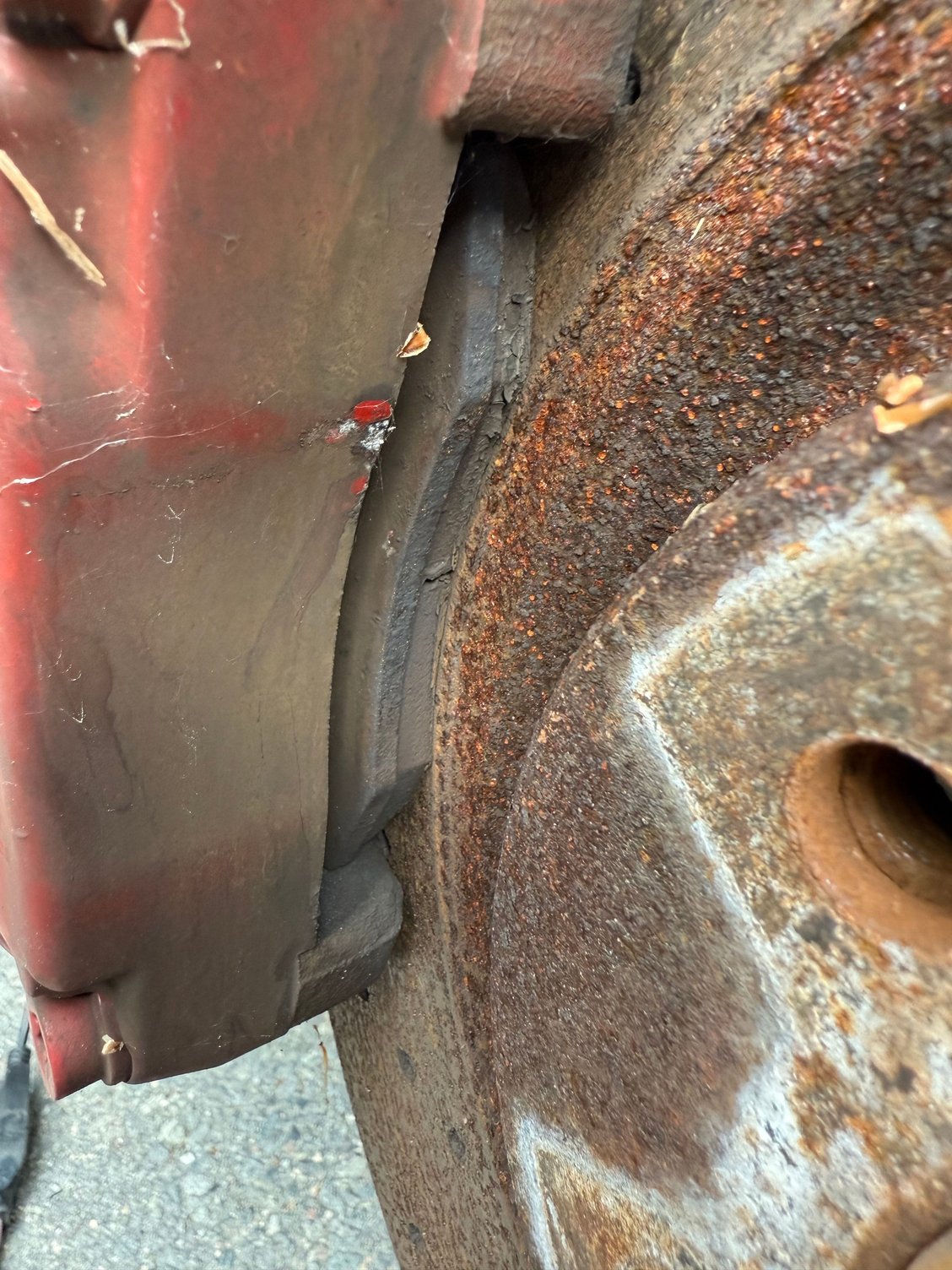

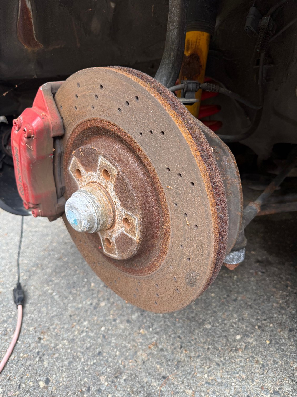

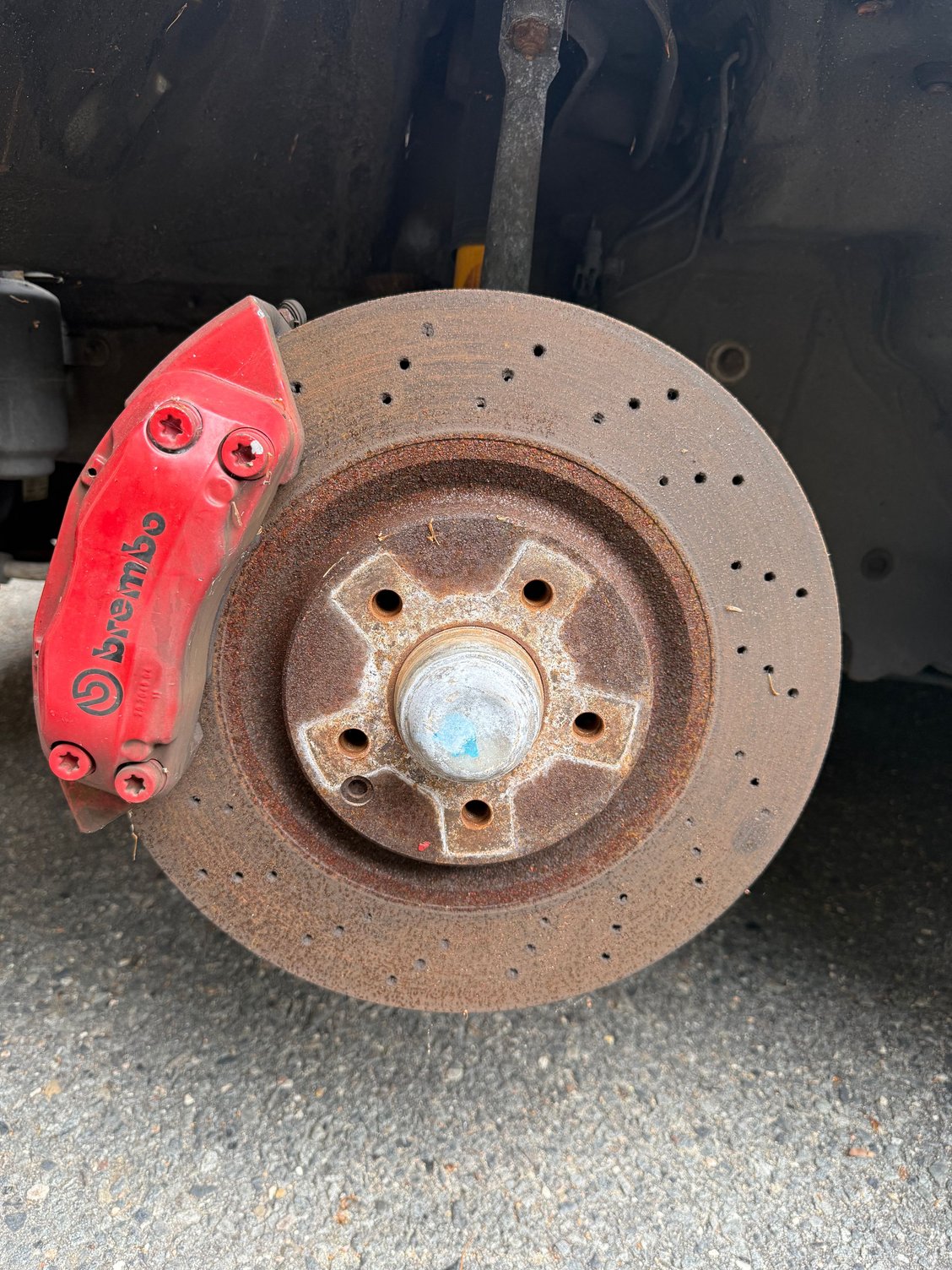

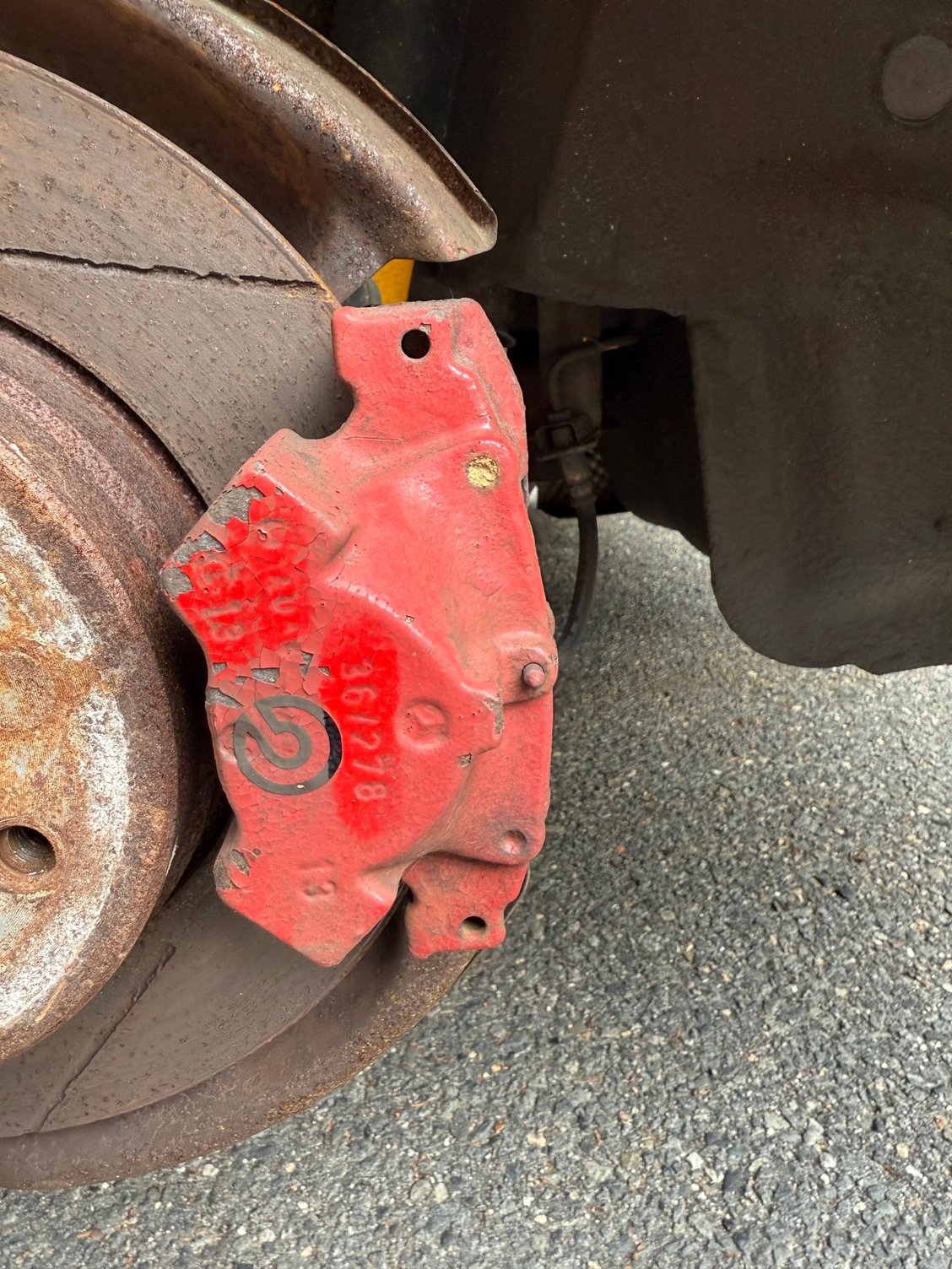

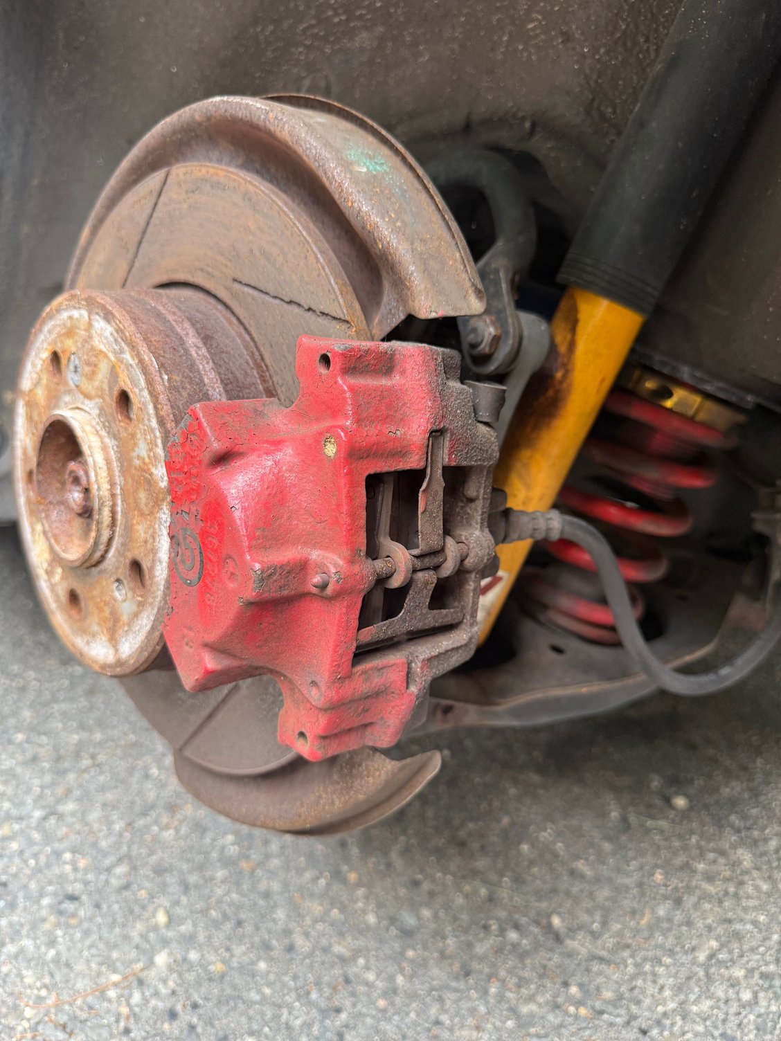

Hi Everyone,Hi, I bought a 2005 Chrysler Crossfire Limited that's been sitting for a little bit and need to do brakes. They aren't the factory brakes and the owner before me said they might be from an 2002 E500 but I couldn't find anything on that and now he won't respond to any of my messages about which car to input the rotors and pads for. I attached a bunch of pictures if anybody can help me out finding the right parts to find. First 5 pics are the front and the last 4 are the rear. Thank you

If you pull the pads off you may find numbers and or identity markings on the pads.
The rear brakes look to be original.

I was thinking the same thing as zip439.
Pull the pads off of the front brakes and take some close up pics.
All of the rotors should be the same as a 2003 Mercedes SLK 320.
I just noticed there is a Brembo part number on the face of the front brake caliper. I can't make it out, but you should be able to.
You can probably go to the Brembo website or contact them with that part number. Then you will know what pads and hardware that you will need.
