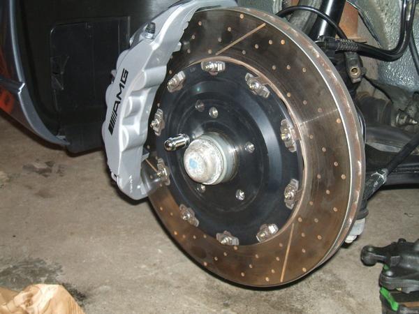

When I was researching the Mercedes parts-bin bolt-ons some time ago using the early SLK55 AMG brakes was one of the possibilities I considered. I say early bcuz these came on ALL 05-06 SLK55 AMGs but only with the Performance Package thereafter. 2007-2010 SLK55 AMGs (unless they have the Performance package) reverted to the same brakes used on the C32 AMG both front & rear. If you want the brakes shown in your link here is all the data I collected on them at the time including the (Mercedes) part numbers. Spacers are for use with Xfire wheels.
(6-piston front, 4-piston rear)
FRONT: 360mm discs aluminum hat/iron rotor, 6-piston calipers 30/34/38mm
REAR: 330mm discs, 4-piston calipers 28/26mm

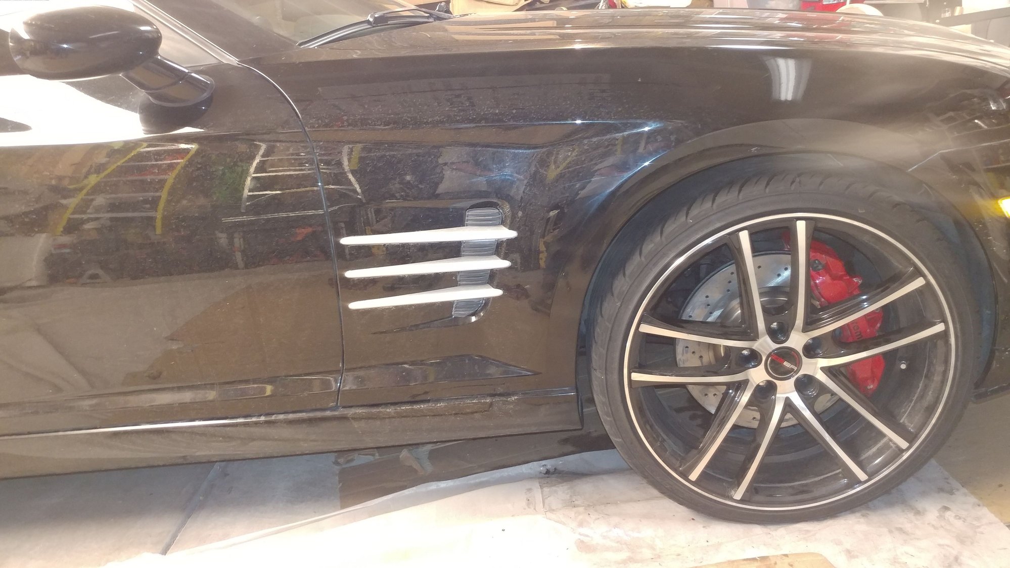

C55 and C32 have the correct brackets for the 6 and or 8 piston calipers to fit Crossfire hub smaller distance from bolt to bolt on the caliper are all the same just diff hub on c55 and c32.
8 piston are a little taller on the hub so wheels are a bit tight. But the wheels you see in this pic and the AMG knockoffs are able to fit the 8 piston calipers

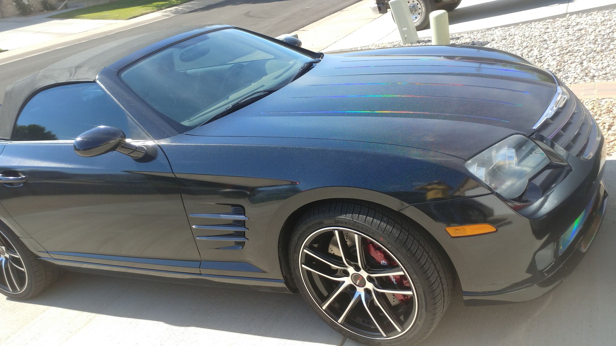

Jimmy skullz, rmaier, Rudy and myself have been doing this swap in the last 15 years on at least 5 to 10 crossfires.
I have done 2 myself and yes the c32,slk32 c55 and with small mods the c500 all from 2001 to 2007
if U want to go fast ,you better be able to stop use the best brakes you can find.
