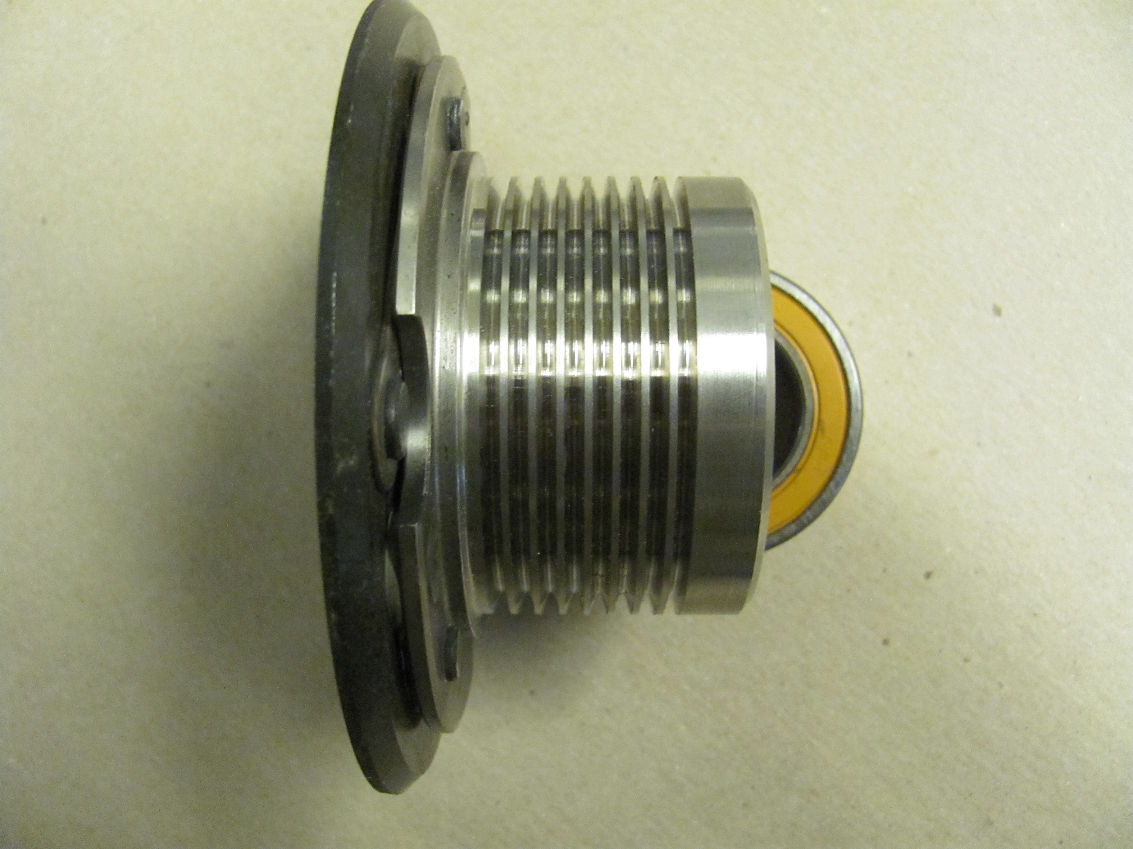

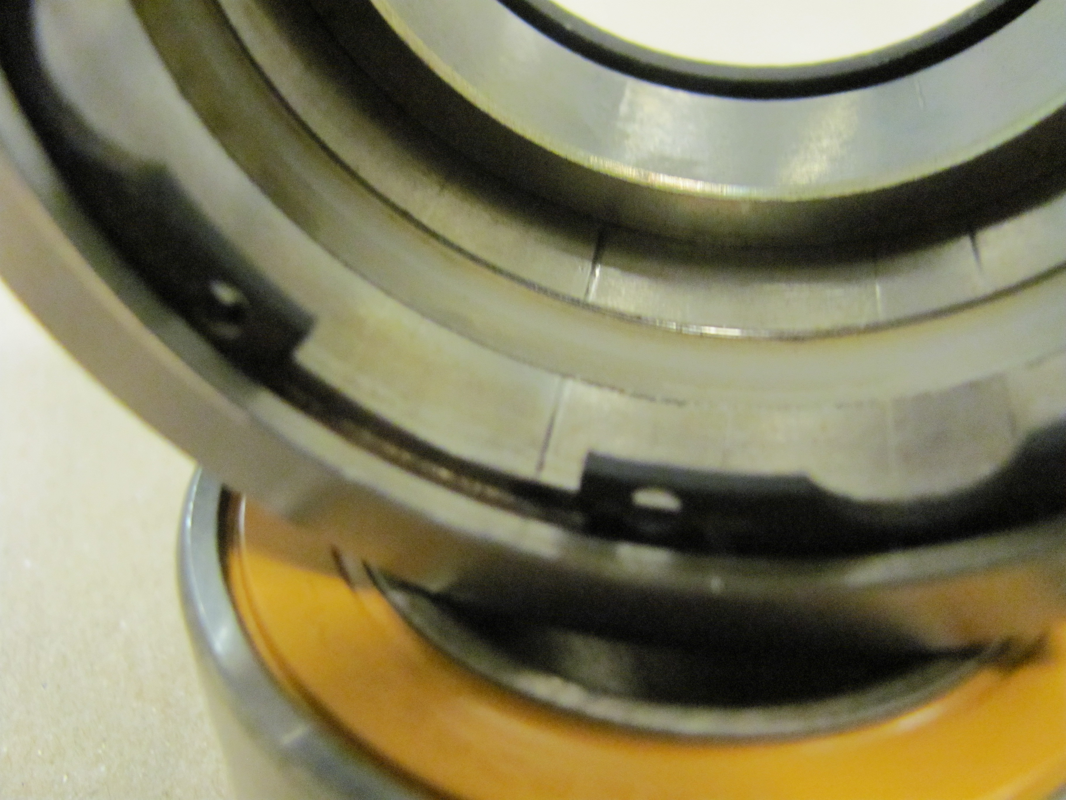

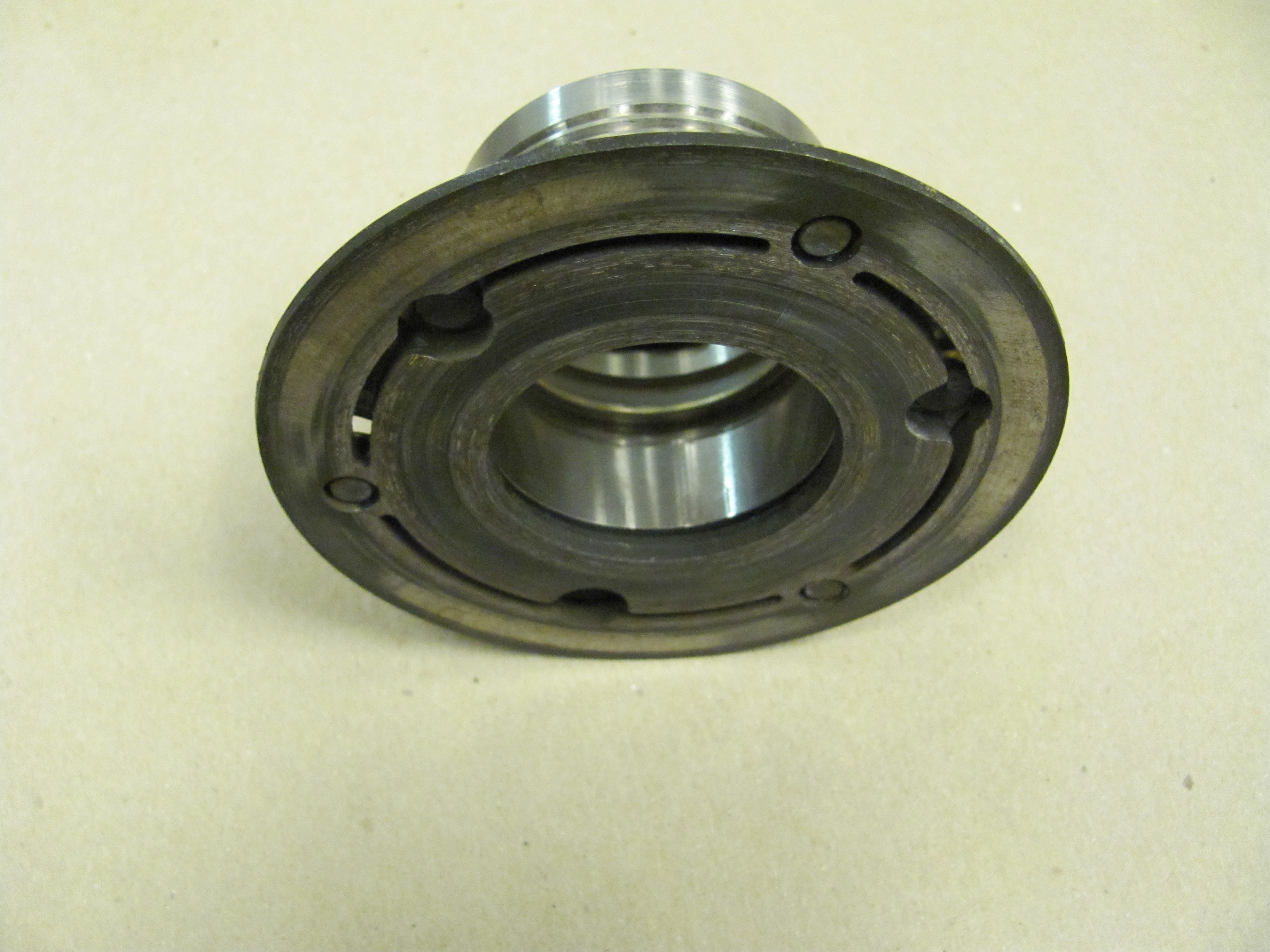

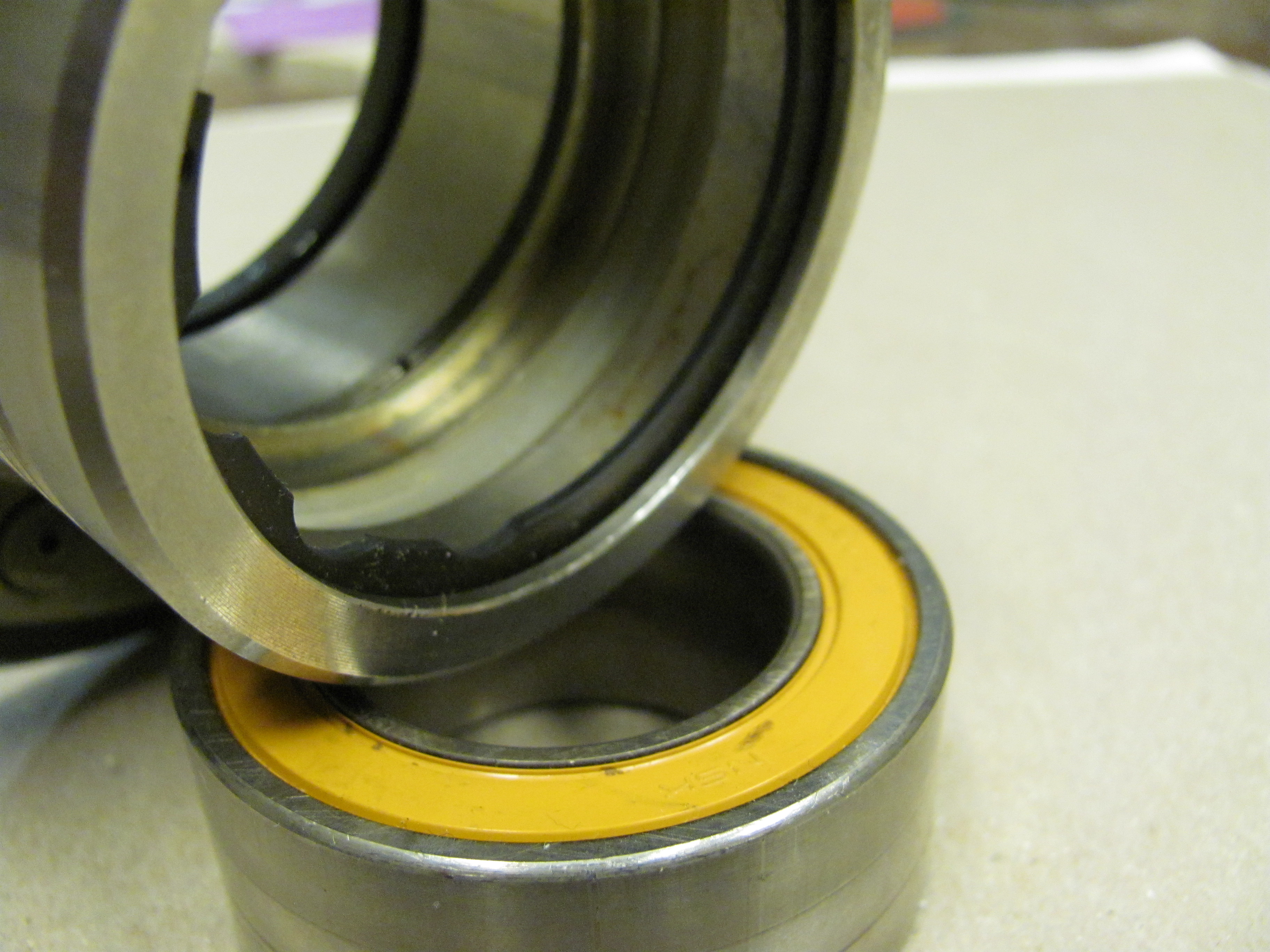

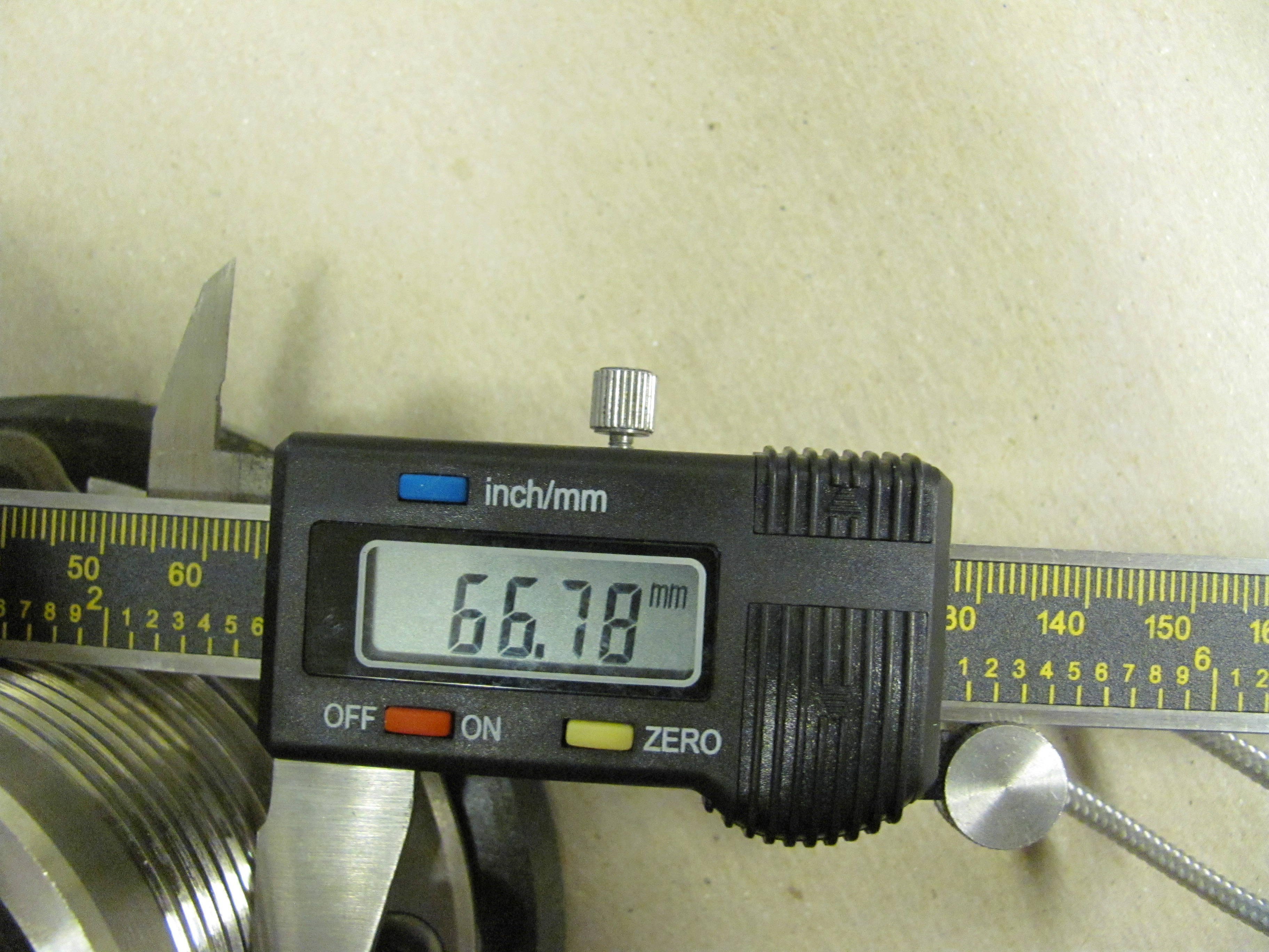

This Stock Pulley Has Been Turned Down To 66.8mm If You Look Closely At The Inside Of Pulley You Can See A Groove That Prevents Going To 65mm Which Would Be Equal To C3. I Can Not Figure Reason For Groove But It Would Make The Pulley Way To Thin. There Is Only A 2.7% Difference. If You Would Like To Have Yours Done Pm Me
$225.00
i Have One Extra Pulley That I Can Do A Swap I Want To Evaluate Yours First
personally I Would Rather Have A C3 But This Is As Good As It Gets For Now.

thats a great undertaking!! maybe post it on the srt-6 section. they may be very interested

Fill that groove with a nice weld, grind it smooth, then machine it to the max. Nice work; I applaud your efforts. I would have jumped on this a couple weeks ago.

That's what I like to see, someone using a little initiative, take the OEM part which is well made and better than the C3 and adapt it. Well done.
The groove is probably the division point between two different diameters, one a bearing fit and the other a shaft fit, with metric standard sizes and tolerances for both.
Edit
Just seen the last post, do not weld it as I am sure you know. That could ruin it really well.
Precision parts are not welded unless every think is welded and totally re machined. The welding would be done with a laser and very carefully, no bloody great spark and heat.

I Talked To Tvt When They Were In Business And I Am Not Sure They Were Aware Of Internal Grove. It Is Filled With Plastic And May Have Been Missed.
