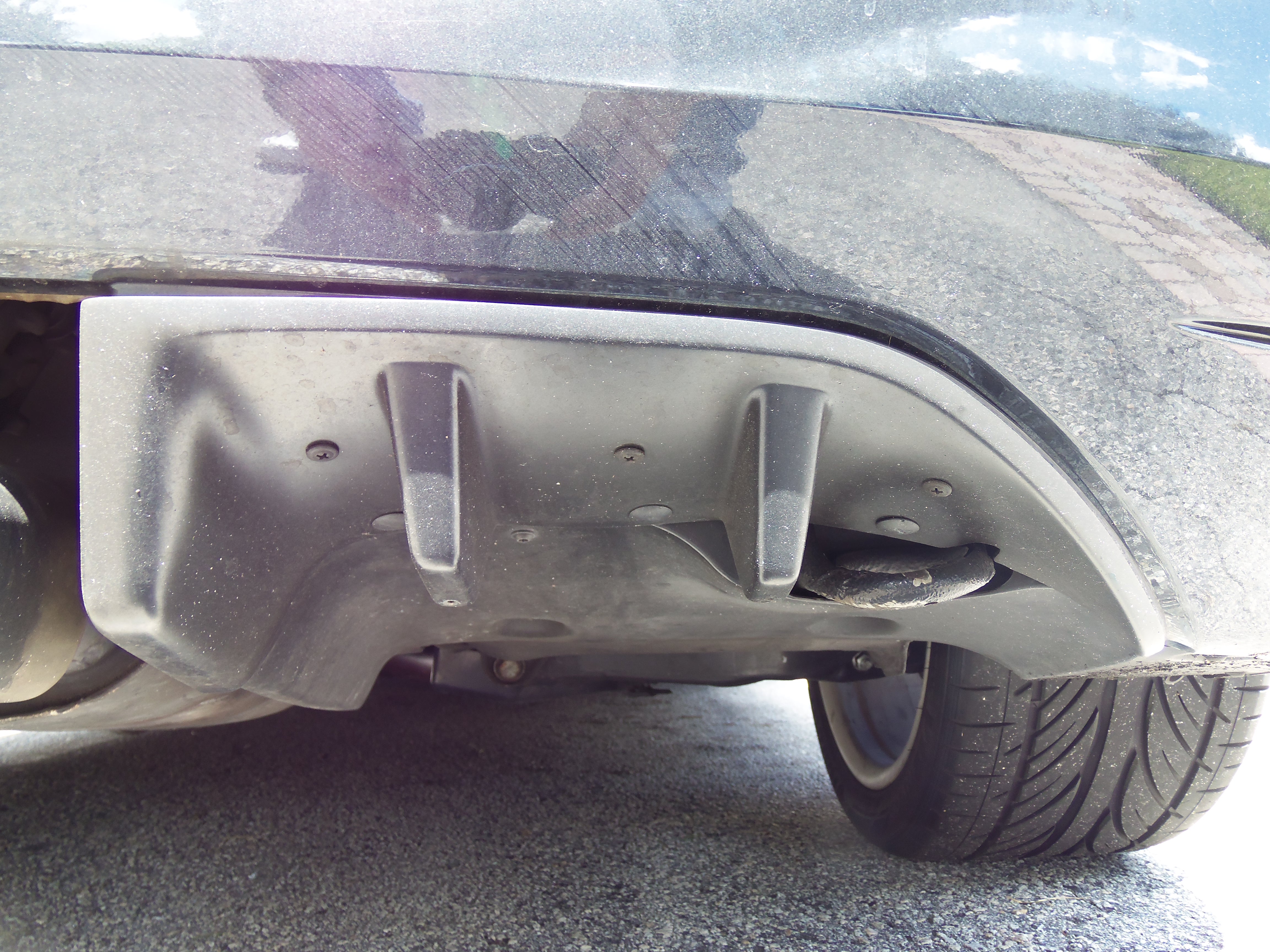

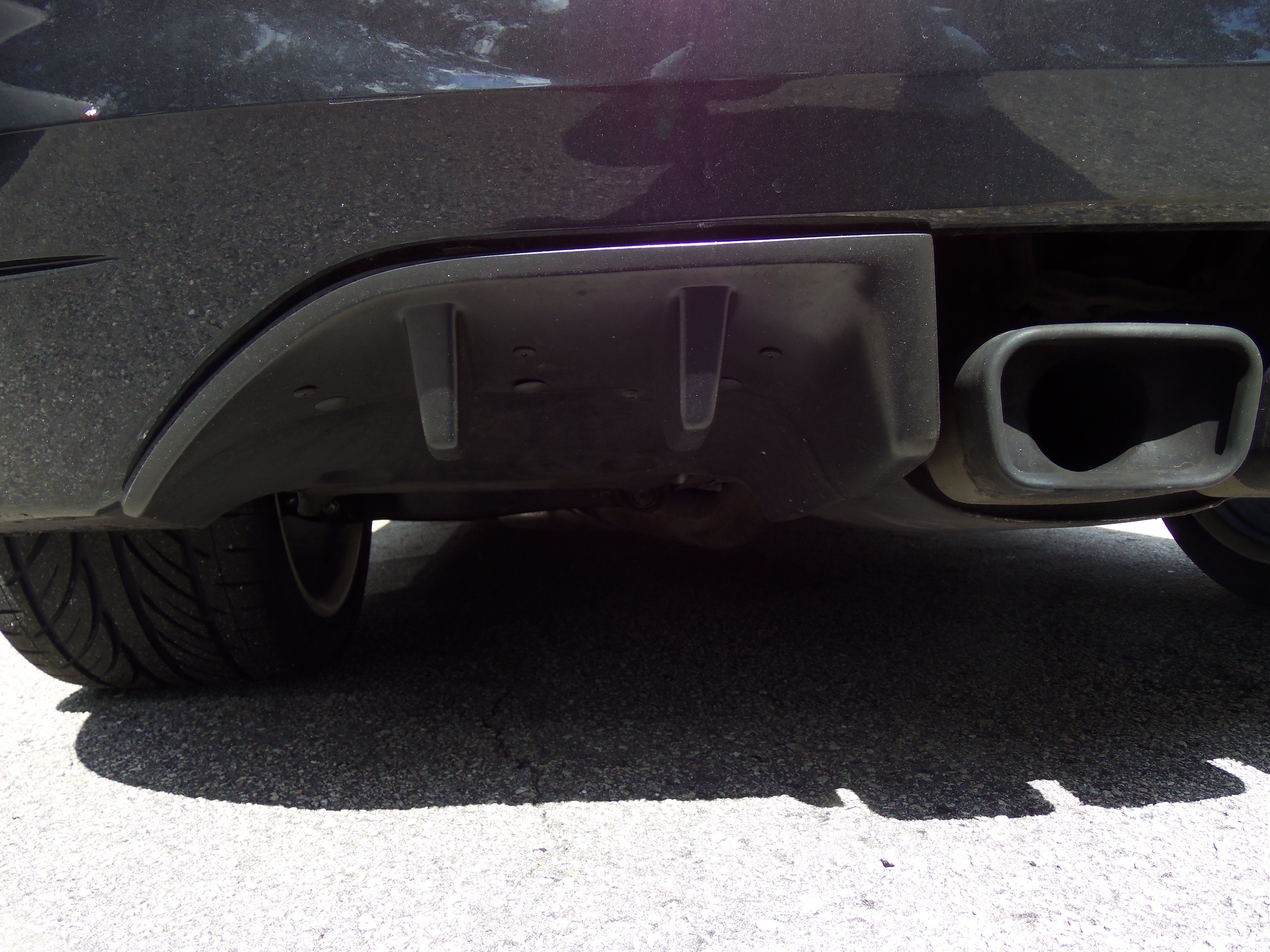

being that I started this thread last January, no one has come up with For the perfect set of diffusers, and finding the ones from the factory is like pulling hen's teeth, so I decided to try the fiberglass ones. I found that there well made, other than being stiff, they did that. Good, with a slight bit of adjustment. You can make them fit almost perfect. Anyway, I'm satisfied with mine,So what I did was. I fitted them up with two-sided tape, then put the push buttons in, then added a couple of black screws. And yes, my exhaust pipes are painted black. my car is not dirty,it just looks that way LOL , it rained last night and i went out to play in our Liquid sunshine. jim

I found that there well made, other than being stifff
[/QUOTE]
Looks good. Adding the screws probably helped pull them in tighter. One other problem I saw was that the originals had a weep hole at the bottom of the fins so that water wouldn't collect and freeze in the cavity. The fiberglass ones did not. When I talked to the owner of the company, he said that was an oversight and they would drill holes in the future. You might want to check on that. If water freezes in there, the fiberglass could split.

yes, mine has the holes drilled in them when i got the, .they have been on for 6 months now and i have checked them at every oil change ( which is every 2 months) ,, so i am happy with what i got. jim
