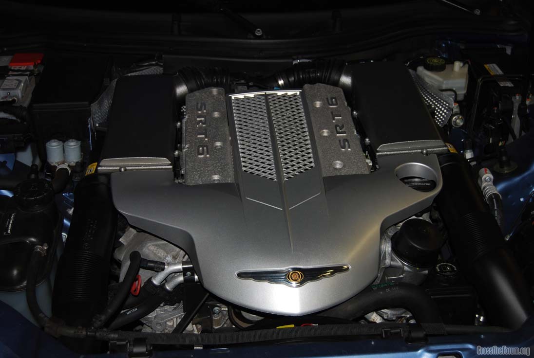

No, all the CAI do not.. a lot of "CAI" have their intake filters right next to the engine bay.. in my opinion what's the point as it's sucking in hot air directly from the engine?
I may be biased, but I believe the CAI from Needswings is the best you can buy for your SRT-6. I have one on my coupe and I can't say enough things about it.. it's amazing!
This is a very good pic of the layout.. it's a coupe but the srt-6 isn't that different at all..
Hopefully Gary (Valkryderguy) doesn't mind me using his car..!
