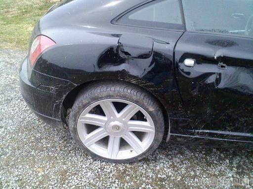

I did the same thing to my side markers only i used three coats they look black during the day and still light up pretty decent at night ill take some pics if i ever get my car back Bambi met the karman steel body at 65mph
Old Apr 14, 2011 | 02:28 PM
jmk41's Avatar
Joined: Mar 2011
Posts: 548
From: Lake Jackson, TX
Default Re: Debadge and tinted sidemarker tutorials, pics!
Aside from the deer damage lol you can see that the side marker light is damn near black
