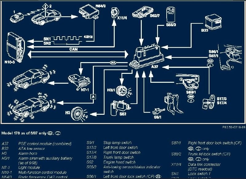

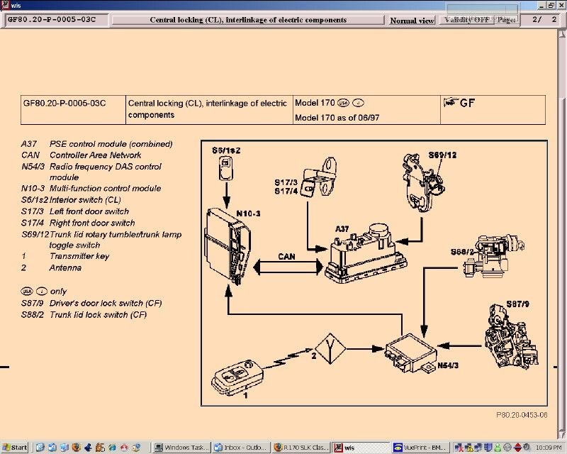

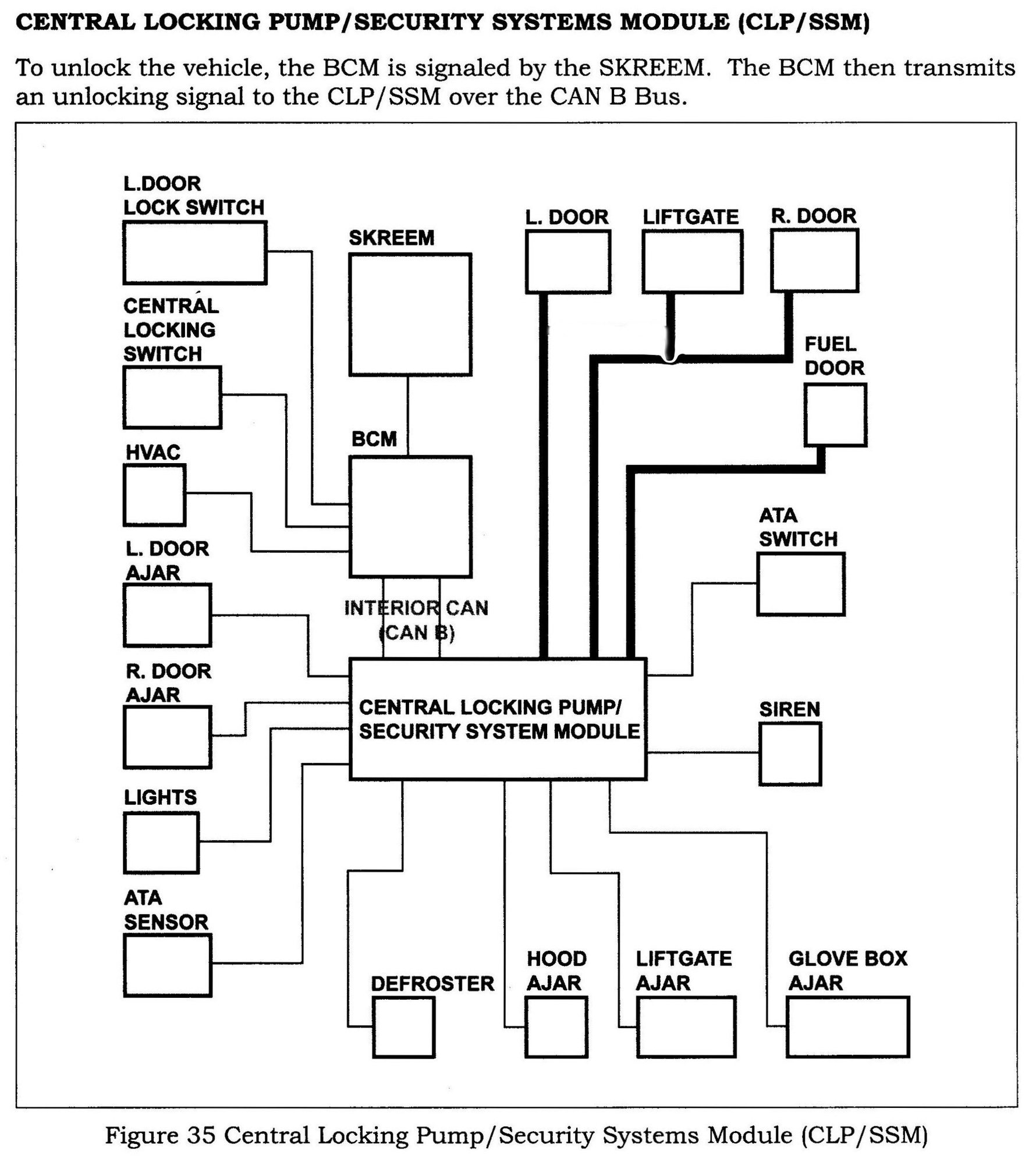

Here are some schematics of the CLP/SSM that I have collected over the years, you can see that it has its tentacles spread throughout the Crossfire.
The first is for the Crossfire the others do not apply directly to the Crossfire, but the systems are probably similar.
