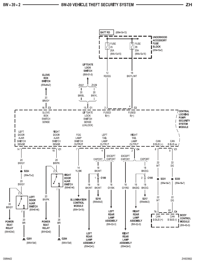

Yes, most likely related.
Have you checked all the fuses ?
Check the signals from the door switches.
( not easy, either at the seat relay or the CLPM ) :
