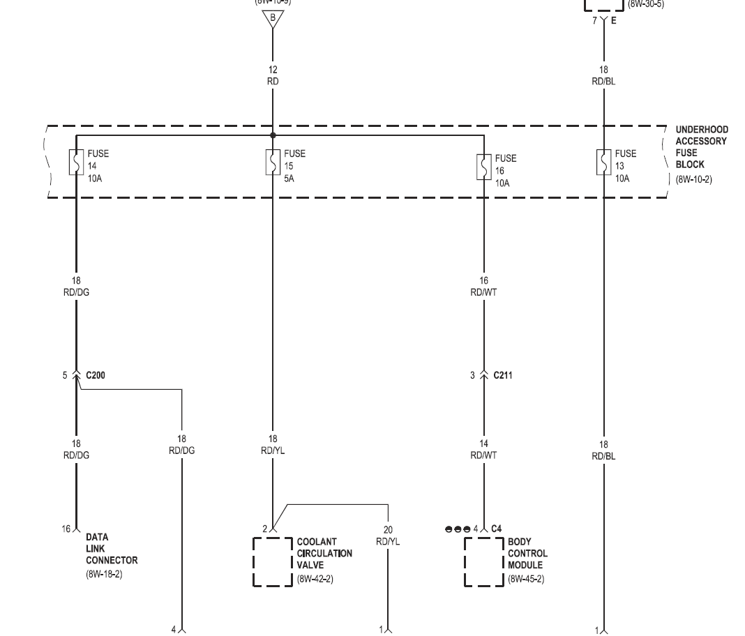

Did you meter the fuse ? Did you check the fuse cavity for 12v ?
My meter probes were too big to fit down into the fuse cavity. I did put the probes onto the top of the fuse (where you can check the fuse without removing it) and I did not get any reading. Time to head out for the day so will resume this repair attempt next Tuesday.
Merry Christmas!

Bob, go back to George's post - you MUST have 12 volts at Pin 2 at all times. If you dont have 12 volts there, THAT is your problem. With the car shut off, there will be 12 volts at ALL three pins and when you start the car, pins 1 and 3 will go to zero or close to zero IF the heat controls are at "full cold". At "full hot" they should go very close to 12 volts.
Now, the diagram shows a direct connection from the fuse to the connector at the valves - i'd caution you to take that less than literally. I've found, over the years, that they took a lot of shortcuts in writing the wiring diagram, there may be a connector/splice/etc. somewhere in the path that has corroded, gotten wet, come unplugged, been chewed by a rodent, etc.
But know this: DO NOT waste any time on any thing now, but getting 12 volts to pin 2.
Bob, says here that fuse #15 feeds those valves, along with the REST pump :
I 'think' a solid ground from the control module pin = NO flow, and open relaxes the valve and allows flow.
Merry Christmas Mark, Thanks for your explanation. That does help clarify things for me. I'll do more research and testing tomorrow . . . Will post and update on what I discover . . .

UPDATE 12/26/17 . . . More progress but still not fixed.
I DO have power at the fuse #15 circuit . . . Sorry had not been testing it correctly. I still have no power to the #2 pin at the heater control valve connector. As I had been previously advised, that fuse #15 circuit his hot all the time and also so should the center #2 pin of the three female pin heater control valve connector. Somehow by SSB roadster is not getting power to that #2 pin.
I will next do a continuity check of the red/yellow stripe wire from the fuse box to that three pin connector. If no continuity (and I presume there will not be), I will try to that trace the routing of that wiring harness to see if I can find a break in that wire. Will advise further when I get a chance to do more.

If all else fails, come off the box in front of the battery with a inline fuse wire to the #2 pin.

They do pulse, I mean, it's like this:
The valves' natural, relaxed state is "open", they must be energized in order to close.
You want full cold/no heat? Then pins 1 and 3 are grounded. The valves are energized, which means they are closed. No water flow, no heat.
You want full heat? Then pins 1 and 3 are open/disconnected, that is, at full voltage. The valves are not energized, which means they are open. Full water flow, maximum heat.
You want medium heat? Then pins 1 and 3 are pulsed with a ground - the valves open and close at a rate designed to give enough water flow to make the right air temperature in the ducts. There are two thermistors, heat sensors, in the heater core - one for driver, one for passenger - they tell the climate control what the temperature is, and it then sends pulses to the valves to 'modulate' the temperature in compliance with what you have dialed on the two wheels.

The 12v to the solenoids is NOT dependent on any computer module. ( see post #22 )
Is there 12v at fuse #15 ? If so, then da mice ( or in your case, da crabs ) done chewed da wire.

Bob, the power ( 12v ) to fuse 15 comes direct from the honking big 200 amp bolt-in fuse in front of the battery, as does most of the other non-switch fuses :
( point "B" is that big fuse )

Well . . . I took my SSB SRT6 roadster up to J S Benz in Miami so they could track down the gremlins and root them out.
Seems that the wires connecting the OAT (outside ambient temperature) sensor to the instrument cluster had a break somewhere. Also I did find out that if the OAT system is not working (reading -36 F) it WILL disable the air conditioning as well as affecting other systems in the car. That OAT system is not just to let the driver know the outside temperature. It communicates with the ECM computer and affects fuel mixture and other things!
Also the wiring harness connecting fuse #15 to the heater control valves had a break somewhere.
They ran new (nicely and carefully hidden) wires to both systems and everything is now working as it should and looks factory fresh. NICE WORK!
