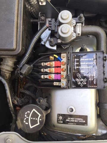

For John and Ella's SRT Roadster (the one they drive quite a bit, it sits in their carport), I went a different way around this. I got into the harness near the duovalve and added a fuseholder and went right to the battery feed. Did my best to make it look good.
Also, I added a note to the card in the fusebox to indicate that "Fuse 15 has been moved to the battery junction box." Fixed in 20 minutes for $5.49 in parts.

That looks good. Adding the remarks on the fuse box card shows the pro touch. The car , no matter where it goes will easy to understand.. kudos...
