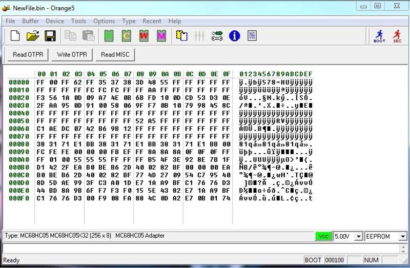

Then read out the EEPROM and save it as a file:

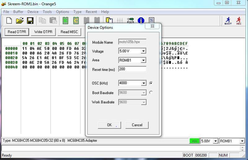

Here you can switch to the ROMB1 area:
And here is the ROM area:

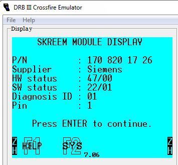

This is what the original Skreem reports:
And so the clone:
Identical.
And also the other parameters were identical:

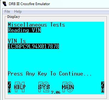

The only difference I could find was the VIN stored on the modules.
Original:
Clone:
This must also be stored somewhere on the processor. When repairing Uwe's Skreems, I simply soldered the processor from the Crossfire to a module from the SLK, so all relevant information must be on the processor.

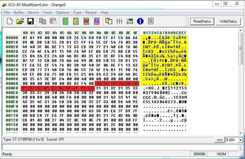

That is not entirely true, I have already cloned ECU so it work for a skreem.
The yellow area shows the data who is important for the skreem, the red area the data for the equipment (automatic, manual, etc.).
The VIN in the ECU can be changed freely - nothing happens.
