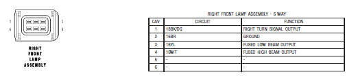

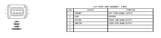

Hey all
I'm trying to tap into the left and right turn signal wire for some two way day time running lights with a built in turn signal function. Where the heck is the turn signal feed wire? I'm assuming the turn signal feed is internal inside the housing. Where can I pick up a feed for the left and right turn signal?
Thanks in advance for any insight from the guru's out there.
Fred
Old Jun 14, 2019 | 03:11 PM
Default Re: turn signal wire
Here ya go :

Thanks pizzaguy. don't have a manual. Is that plug the one that plugs into the headlight assembly?
Thanks again
Old Jun 14, 2019 | 06:27 PM
Thanks again
It was me, not Mark ( pizzaguy ) that supplied that diagram.
The answer is yes, those are the wire connectors to the headlights.
