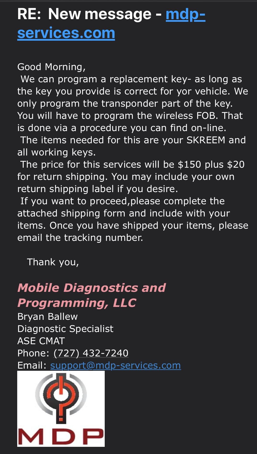

This is what I received from MDP today. I’m confused as what he means as correct to my vehicle? Is he meaning that it’s not from another car? I explained to him in an email that it’s never been programmed to any car.
I once bought a mercedes key (from another car) that had the correct part number and RFID (55) with assurance it could be programmed to work with my car. The dealership could not do it .. I hope these folk can.
So to answer you, the correct key (fob) for your vehicle will have a part number and RFID number exactly the same as the OEM that came with your car. There are many of them out there.
I have to be very careful how I word this. To my personal knowledge,,,,,MDP as in Bryan ,,, is the only company in North America who Can create a transponder key that will allow you to start and operate your car as well as open doors manually with the locks with the possible option of recoding your key fob as stated in his listing. If there are other companies that offer this service please post them here. Let me add that his company can fix and repair your existing skreem and or re program as in clone other auto wrecker Skreems allowing spares for an emergency. It was as I have repeated many times the work of wolfstalker who found this company. Hoping everyone will share with the crossfire communities. I had a wonderful visit with a top hand with West Coast crossfires out of Vancouver and asked him to share this info to all of his members on facebook as well as their own forum.
For those of you who have a running functioning crossfire such as myself,,, please look at things this way. If we have a handful of spare parts in the trunk or glove box our confidence level soars and we will feel comfortable driving these amazing cars absolutely anywhere. The resale of all crossfires would also regain its footing . Its a win win situation for everyone. I didn't get a reply from Toolman as too other options because again to my knowledge ,,,,,,their are none except MDP. Thank you to all the forum members who have emailed . It has been a pleasure to chat with so many amazing people. All the best now and forever.

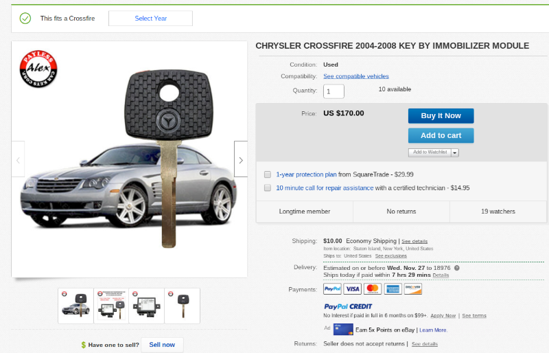

Has anyone tried the special Crossfire limited function key from this ebay seller? This appears to be like the keys MDP sells.

As far as the key advertisement that you posted for creating a key that will start and run the car ,,the add says $170.00 I would be happy to provide the crossfire forum members with cheaper alternatives . Yes I have found several . I don't have all my notes by my side at this moment but let me give a quick example so a war doesn't break out. paylesscarkeys .Their add is 149 for one exact same key as the $170 add or two for $199. and they were not he lowest. everyone has my email ,,contact me and I will get you access to my notes. Why have I not posted any of these locksmiths that can create keys. Exactly that,,,,,,thats all they can do is cut keys. They don't fix skreems or ECU modules ,They just cut keys and we are a thousand miles farther down the road than just keys.

I didn't post this originally.
Another crossfire member posted the reply they received from MDP,,, This is the price they were quoted ,,,,,,not me !
I reposted it again for those of you who are only interested in a key .
Toolman must have missed this or he wouldn't have posted the key add from an unknown, unproven ebay seller for 170 plus another 10 for shipping .
