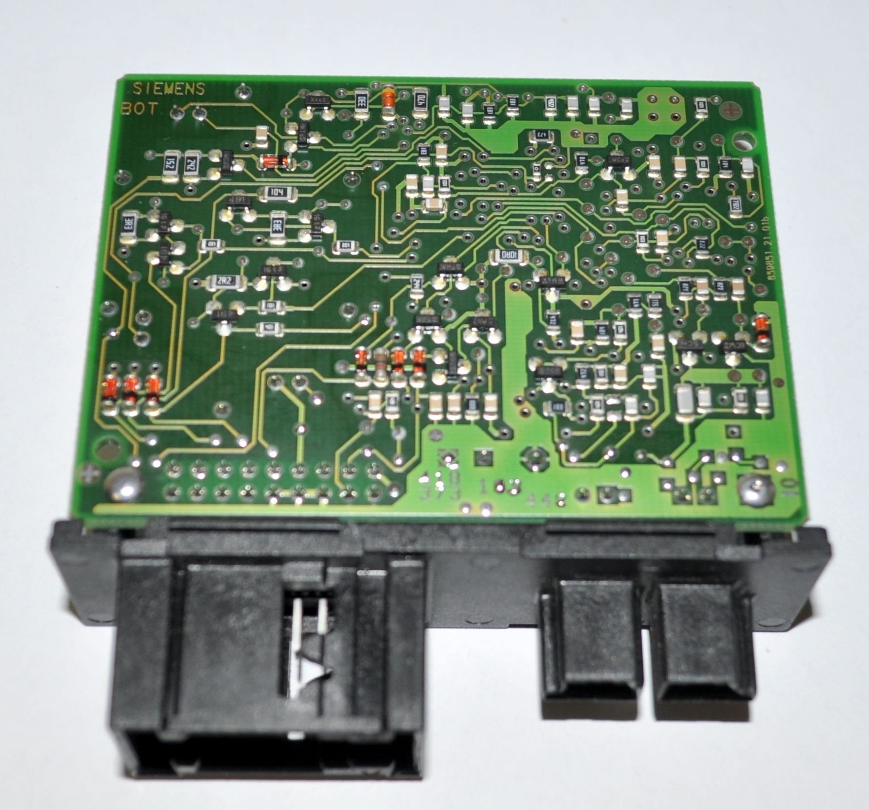

I imagine it is like a green board with little things soldered to it. Like the RCM? Or that part the guy was soldering on. I have absolutely no knowledge or interest in how these things work. Once carbs and points and stuff like that disappeared I knew I was a dinosaur. I used to think a Mallory ignition was state of the art on a flathead. If a voltage regulator or generator crapped out, you got a new one - or a rebuilt - at Napa. Made lots of trips with those cars with the manual or power tops down, girlfriend nearby, never got stuck. This stuff with all the sensors and FI and electronic systems is far too complicated for me to cope with. I can't figure out why I would want a lock system like this or a system that shuts off the motor at stop lights or steers for me when parking. I even pulled a hydromatic out of my '50 Olds convert and replaced it with a LaSalle floor 3-speed when I was in high school. Good shifting with Sally next to me..... Those were the days - down with consoles. Sure, the tops leaked and the radios were elementary, but to my mind Those Were The Days.
The SKREEM insides.
I wish there was a solution, but I must say, I do not see this going anywhere. Chrysler has almost ZERO reason to put any effort into this, and given the B.S. in the evolution of the car and the merger, and then the breakup, this may not be as easy as some of you insist that it is (I mean for them to resolve this). Yes, of course I could be wrong; but in electronic manufacture is it NOT always as easy as grabbing an item off a shelf. There were patent and other considerations here - there were odd issues with cars being stolen in Europe at the time and in order for insurers to keep insuring them, the car had to be "un steal able" - this from Clink Spevak (retired engineer from Chrysler, he was in on the airbag/ABS/TPMS system). I am not clear on what changes were made and when they were made as the SLK320 faded into the sunset and the Crossfire was made; Clint started to get into that and got interrupted. (This was at our last event...)
BEST I can think of to do is what I am doing ---- take steps to protect your SKREEM as a part of maintenance. For those with a nuked SKREEM, I know it's too late, but for most of us, it is not. Personally, I've owned three Roadsters in ten years, driving them a total of over 100,000 miles, never had a SKREEM problem. No one individual in my vast personal Crossfire circle that I can think of has had a failure. But it DOES happen.
I've thought about what could nuke the little module that Dave (180) has shown you a photo of. After more than thirty years in electronics, most of which is aftermarket automotive electronics (I work as an R&D engineer for Kenwood), I suspect that I have a clue or two as to why they are failing. But I do not KNOW for sure; I look at the electronic issues we have with the SKREEM, RCM, Fan Modules, etc., and compare them to the battles I fight at work to keep our products reliable and I think I see some ways in which we as owners can possibly protect what is apparently a vulnerable item in the electronics of the car. No guarantees here, friends, but after thirty years (the first 20 were in repair at the component level, where you learn a LOT but earn NO money) I do have guidelines I follow myself.

My suggestions, in order to protect the SKREEM (and in general, the rest of the electronics of the car) are the following ideas that are my general rules for any vehicle manufactured after about 1995:
1) Keep battery cable connections TIGHT and CLEAN. Replace the battery at 48 month intervals; do not buy cheap off brand batteries.
2) Do either one of these $20 mods TODAY:
https://www.crossfireforum.org/forum...le-engine.html
3) Convertibles: Do not put the top up or down without the engine running.
4) Do not jump start a Crossfire with another vehicle, use a 'booster battery' only. (And of course, do not use a Crossfire to jump start another vehicle.)
5) Do not connect battery tenders or chargers with the car's battery cables attached. Disconnect the car's battery cables so as to completely isolate the car's electrical system from what ever 'tender' or charger you are using.
