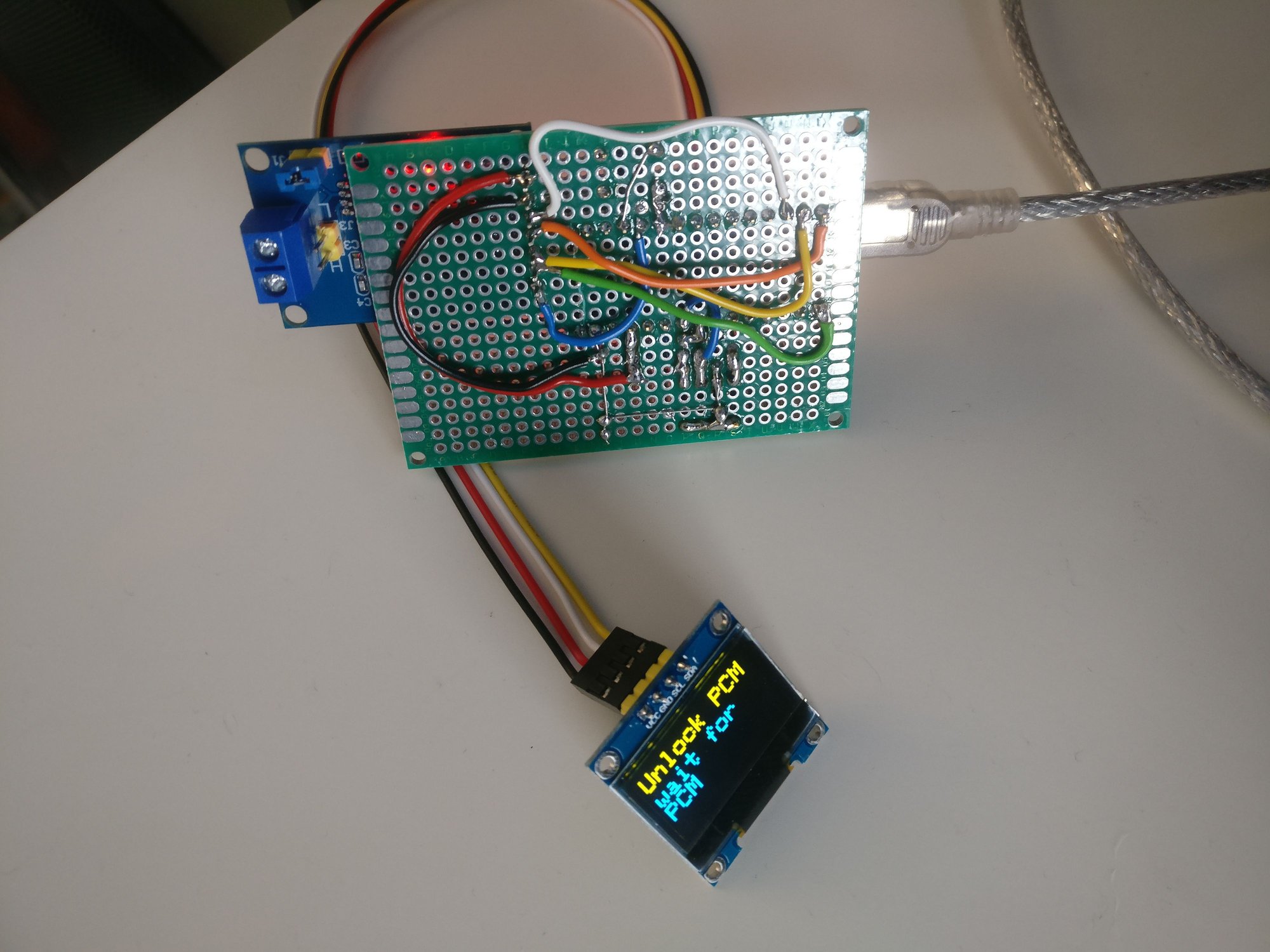

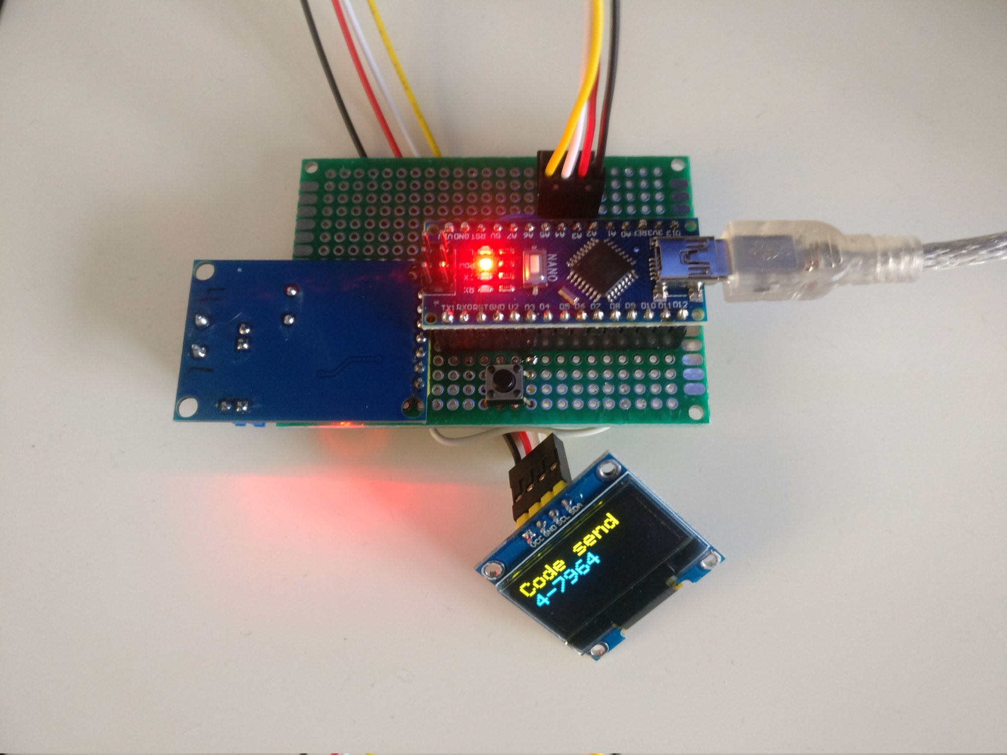

Here the second prototype on breadboard. Now I have to construct and print a case for the board and the display, then everything can be tested in the Crossfire.
The top view.
The bottom view.

Do you anticipate that what you've come up will be a generic skreem that will start any car, manual or automatic, or will it have to be programed by VIN.

You are too clever for me, I do not understand any of it.
my fingers are crossed all works better than expected.
are you trying to make it a plug and play, or additional coding tonget our cars in sequence with you new module ?
Yes my goal is to make a generic skreem, so the problem with the not available key fobs were be also solved. I thing I will go a way to unlock the car with RIFD or NFC Tags. If your skreem already works, you can read out from that 4000 codes (if your skreem has already so much) my module will make with a trick 8000 codes of them. No PCM programming necessary. You can repeat this so long until your skreem has no more codes.
If your skreem is broken you became from me 8000 codes but your PCM had to be programmed that it will work with this codes. If you have used all 8000 codes you will have two options:
First: Buy an other EEPROM from me with 8000 codes (or buy it at one with my Skreemulator).
Second: Reprogram your PCM and reset my SKreemulator, than you can use the 8000 codes again. This can be repeated infinitely.

I try to make it as much plug and play as possible. For your other question see above.
