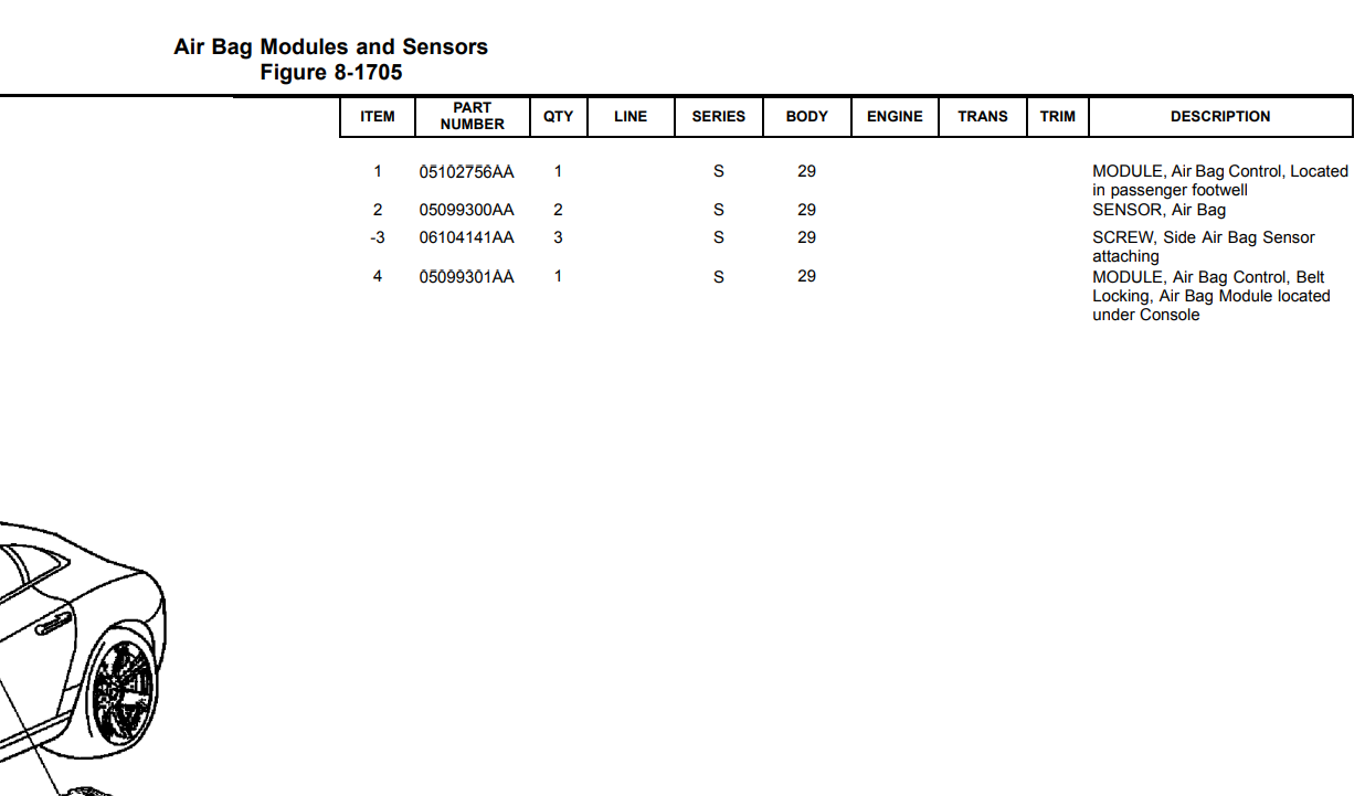

Same issue airbag light on, have not bought a good reader yet, but do have a question about replacement module number.
Group saying MB 001 820 08 26 but in the Crossfire parts manual it shows two part numbers,
05099301AA - Airbag Control Seatbelt locking
05102756AA - Airbag Control.
Question which one is the 001 820 08 26, and which one needs replacing (until my Innova 3610 reader shows up, only reader I heard that will reset the airbag code?)

@Woodgang
This is #4 on your code list and it is located on the floor, inside & under the center console.
This is where i bought mine ( https://www.proxyparts.com/car-parts...airbag-module/ ). You need to find this part from a Crossfire or another car that didn't have its airbags deployed and just replace it and reset the SRS code.
P.S I didnt have a code reader and therefore i don't know which code reader is suitable to reset SRS codes , the independent garage that fixed the car used a laptop with a MB program to do it.
P.S.2 This where the module is:
Good luck with your repair
#1 is the Passenger-Side Airbag.
#4 is the Driver-Side Airbag.
