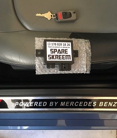

Rob and Needswings.com is well known and has the knowledge and connections to resolve any of our SKREEM issues now
I recently bought a spare SKREEM made VIN specific to my Crossfire for immediate replacement if ever needed

I don't have a specific amount for the spare because it was part of a larger job I had Rudy do for me
He lives only 40 minutes from me fortunately
I posted in a thread recently after having this done
https://www.crossfireforum.org/forum/943015-post4.html

First of all Welcome,
Yes my spare SKREEM is programmed to work for my specific VIN and with my original keys
It is a very complicated thing to explain but Rob at Needswings would be the best one to contact to answer your questions correctly
586-531-1413
