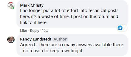

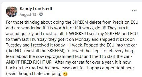

So we can only see this info if we join that FB group, but they can see all the work that has been done on this open forum?
I know many of these forums have copied all the info from this forum without giving credit to the author.
Old Nov 30, 2020 | 12:01 PM
Posts: 13,974
Likes: 1,297
Default Re: SKREEM Module Replacement NEEDED
The "6 replies" above:
