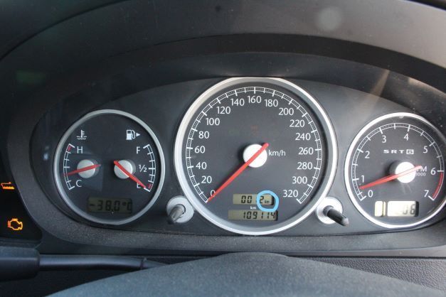

The main problem with changing a cluster from Miles to Km is that the central LCD (odometer) display must be changed. The LCD physically displays "miles" or "km" depending on its original type. It's not a programable/graphical display, so it can't display anything else. The cluster can be re-coded to record and display miles or km and Fahrenheit of Celsius, but you can't change that LCD display without swapping it. New displays are available, but the coding change isn't something that can be done by a Dealer or through Star, Micropod etc. It requires editing of the cluster's eprom file, and a knowledge of what to change.
km odometer display

Don't get me wrong, it is possible to change your cluster, it's just not easy. If you want to change it, I'm sure Josh Chase (at the Mercedes Swap Shop) could do it for you. I know Josh and could tell him where to get the display from, and I'm sure he knows which codes to change. There's actually three displays that will fit, one has "km", one has "miles" and the last one has nothing. You could also find a good metric cluster and ask Josh to set the milage to the same as your existing unit.
BTW. For those that are interested. It's also possible to code any cluster for a 200mph/320kmh speedo range, but you'd have to get a different decal to go with it.
