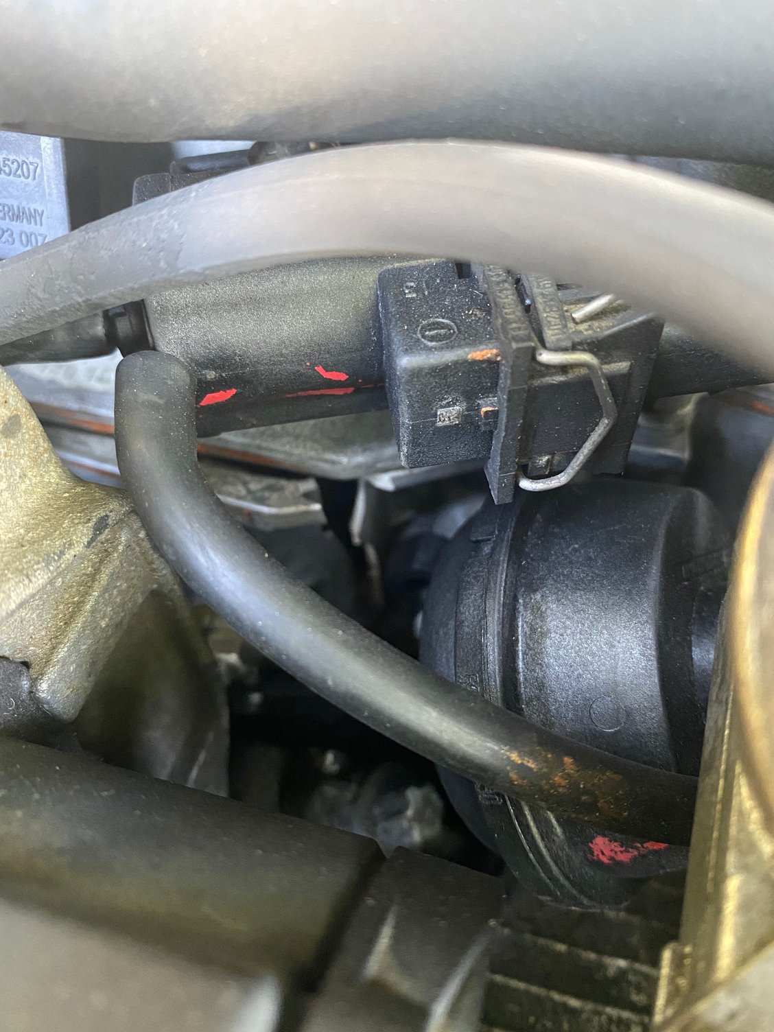

My 05 NA has blown two intake manifold out . Both times were preceded by big backfire. I’m wondering if the crankshaft position sensor is defective and could cause this backfire?
You can see the hole just above the hose
