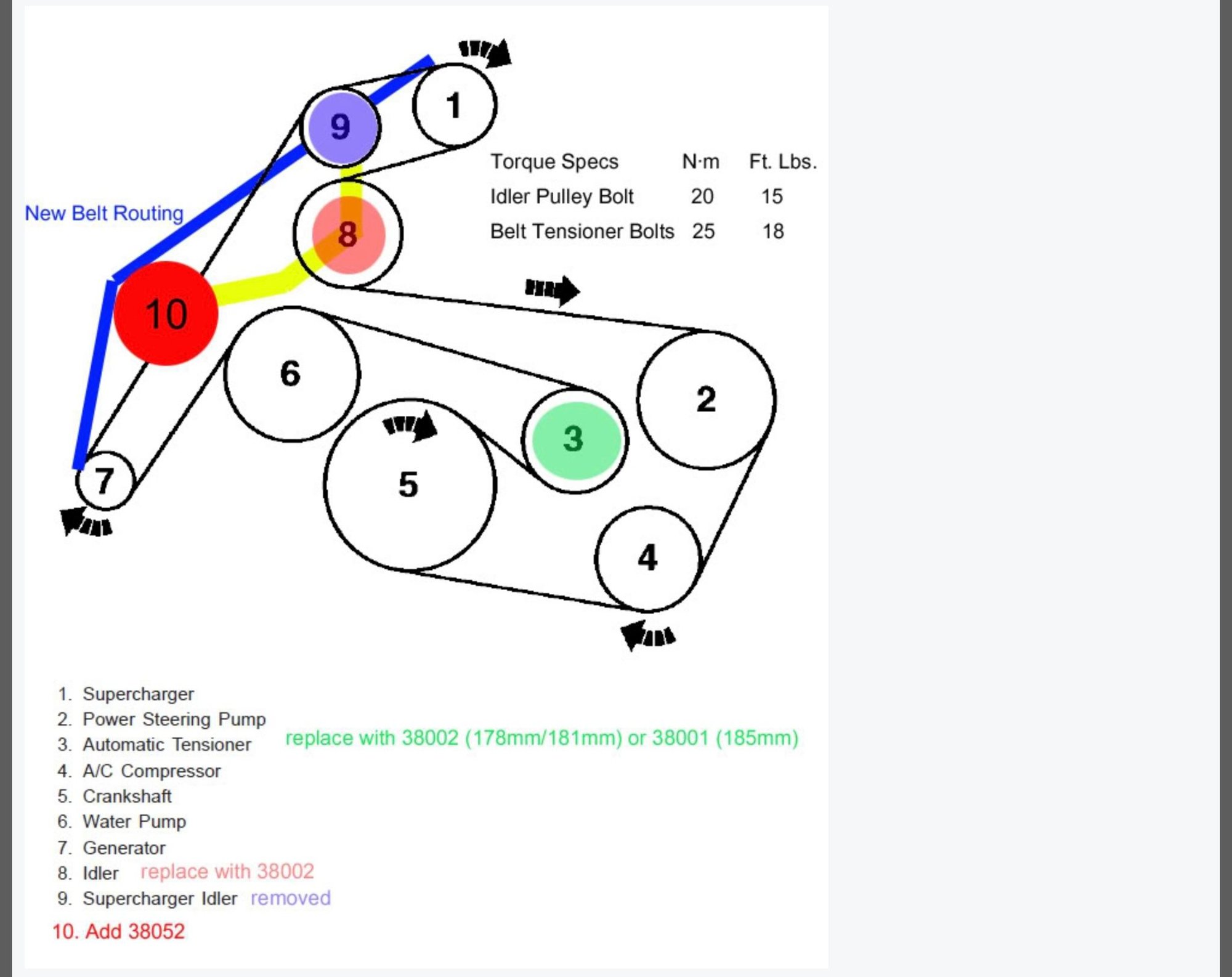

My SRT came with the NeedsWings Pulley Saver and my radiator hose blew and the serpentine belt came off and I had to pull belt off pulleys so I could remove blown hose and now after downloading all 4 different diagrams (which none are the same, some show7pulley (NA) and SRT 8 to 9 pulley) I am asking if someone can send me a diagram with the Pulley Saver installed.
Sorry was in wreck and know have issue understanding thing. I look at engine bay and pulley are not in the same place as in the diagram. The pulley is in different location some are close and some farther away than show on diagram. If I could get help with pulley labeled and if possible, maybe a picture showing belt position over supercharger and were it go after that. And I order new hose (upper house) but it's the wrong one. I found right one "expansion coolant reservoir hose" but only on Ebay but they are all used. Search the web and all sights say it was discontinued and help here to would be a great help.
Thank you for any help
Sive

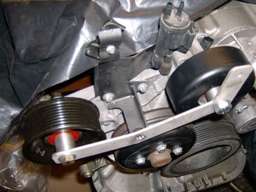

Here’s a print out of PSK with the corresponding new pulleys and belt rerouting
Real world pics from the forum
With the upgraded longer HD green belt
Let me know if you have anymore questions. Oh that hose you’re looking for I think Needswings has it, not 100 certain though.

Thank you it all make sense now
Sive
