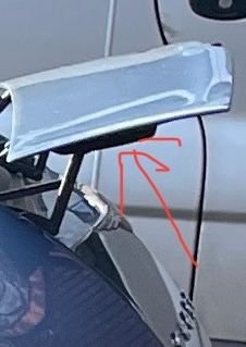

The only issue with my coupe when I bought it was the spoiler not closing. I followed all the forum fixes and stripped out the motor only to find the plastic linkage hinge covers were stopping it closing. Once I swapped left for right again it’s good as new.
Anyone searching spoiler not closing, check that first!
