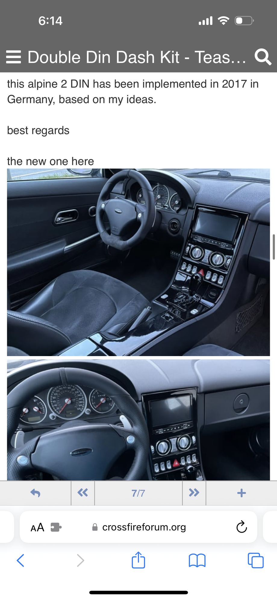

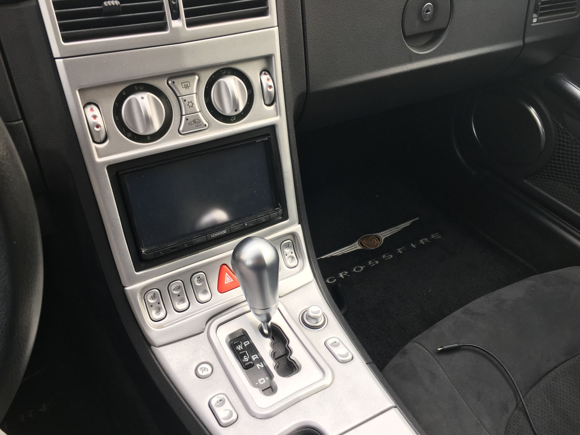

The photo in post #1 is my car. That was done with AOZ parts, they didn’t fit real well. I have two other cars I would like to do, hopefully someone will print a nice set of bezels.

I just noticed how many install photos were in post #1, my car is the first one. I don’t remember how much I paid for those bezels but I don’t think I would hesitate to pay $250 for bezels, maybe more. When I drive one of our other Crossfires I really miss apple car play for music and maps. I also added a backup camera which is nice coupled with the larger display.

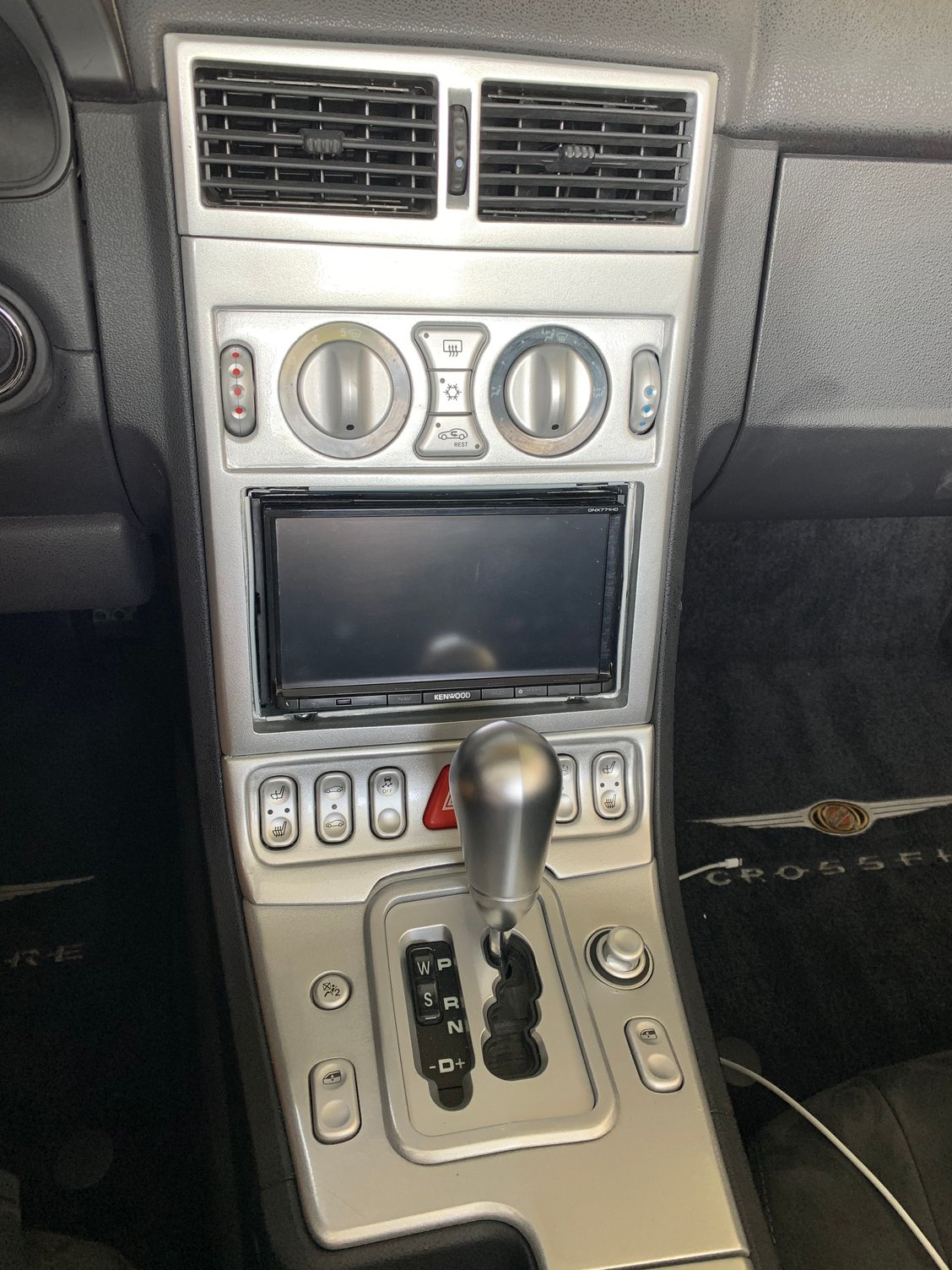

I made two double din installations, the first kept the ash tray where it was originally with the buttons in the centre console. The second got rid of the ashtray and had the buttons placed where they were. The ashtray and passenger seat alarm were installed in the window up/down bezel above the window switches. The radio and switch bezel were made in one piece.
All bezels used OEM parts cut to suit.
