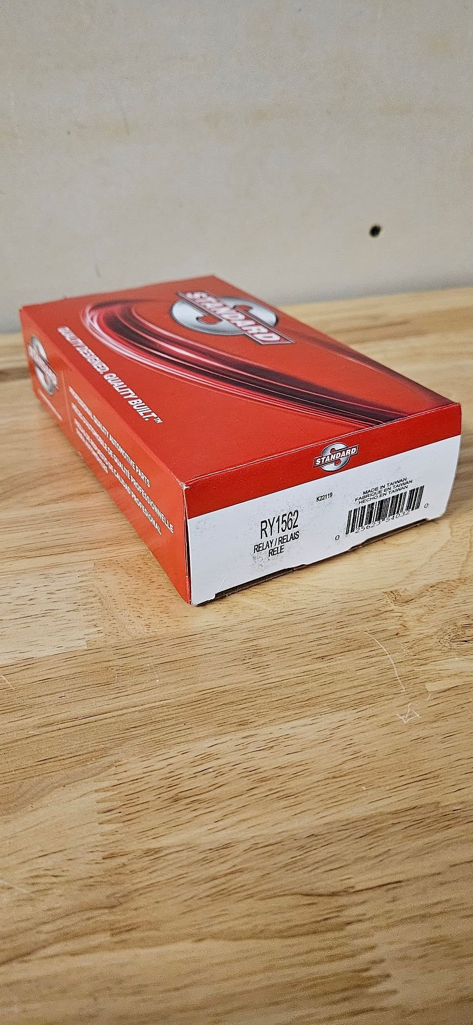

The RCM could be bad, you could get a new one from Amazon and then send your original out to tighed1. You should have a spare RCM on hand anyway as well as a spare crankshaft position sensor (BOSCH only).
The starter sticking could also be a problem with the starter's "throw out bearing". That's the part that spins the flywheel to start your car. It could also be a bad ignition switch that is getting stuck in the "on" position.
These are all guesses. Without actually being in person and seeing what's going on, it's hard to diagnose the problem.
I would start with the RCM first though.
I've included some pictures of the RCM. It's located in the big box near the battery and is the closest to the engine.
The RCM is indeed the place to start. Get a new one and send your used to tighd1 for repairs/update.
