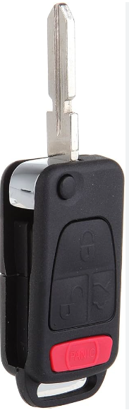

I'm trying to figure out a company that makes the original key cases. I get my cases from the SLK (all black with the red panic button or all black with chrome button and surround). But I would love it any of the manufacturers made a reasonably inexpensive key fob shell in the original color. If you know one, please let me know. Not trying to get a new key, just move over the chip, transponder and cut-out key to a new shell every so often, when they get worn.
Last time I did it, I used this shell, which is pretty nice but not the original:
I used this one from LA Car Tech.
The only thing is that you will have to use there blade and have it cut to match yours. The original blade will be slightly smaller than theirs. Any auto-locksmith can cut a blade. It cost me about $35.00 to have mine cut.
Link to La car tech key fob
