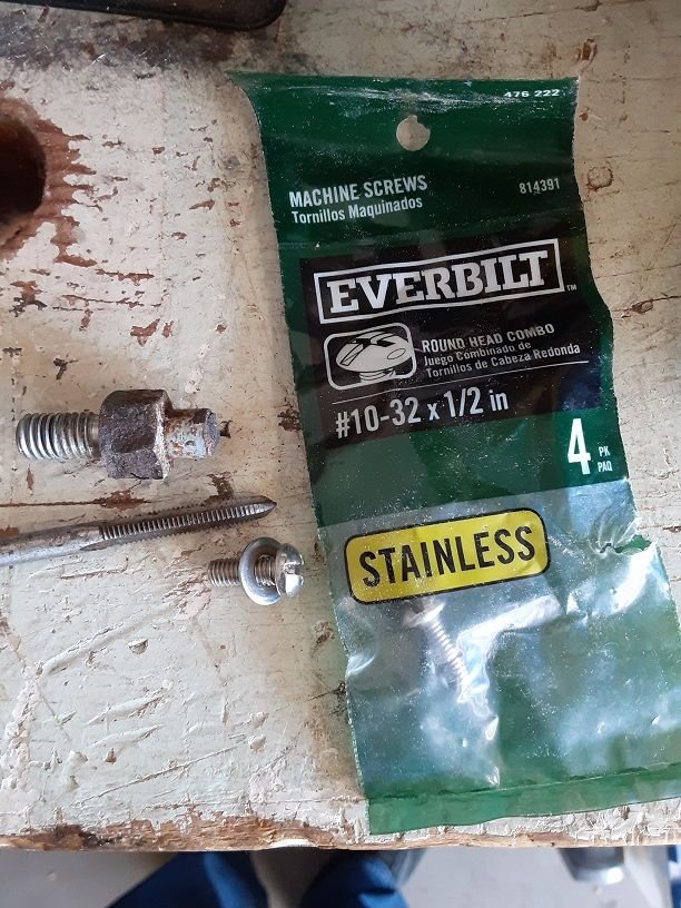

Thanks but that's a bit too pricy for a simple repair. If I were doing an all original resto -, I would consider it. Here are pics as requested. Having never posted before I reduced size and hopefully didn't screw it up.

Fixed, sort of.
Removed the bolt (M8x1.25) ground the end clean and flat, center punched, drilled #21 bit, tapped 10-32, and what the British would call a "bodge" told myself it should hold up for a few years. Ugly but it works. Thanks for all who chimed in with help.

The ball end stud is easy to find but fits the lower end. the upper is different. Thanks for trying! Seems like I have a whole staff of parts researchers here.
