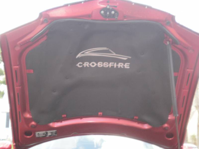

green-ghost's Avatar
Posts: 1,495
From: Somersworth, NH
Default Re: Hood liner sagging ... need suggestions
Or try one of these, theyre on ebay for 79 bucks which is a good price.
