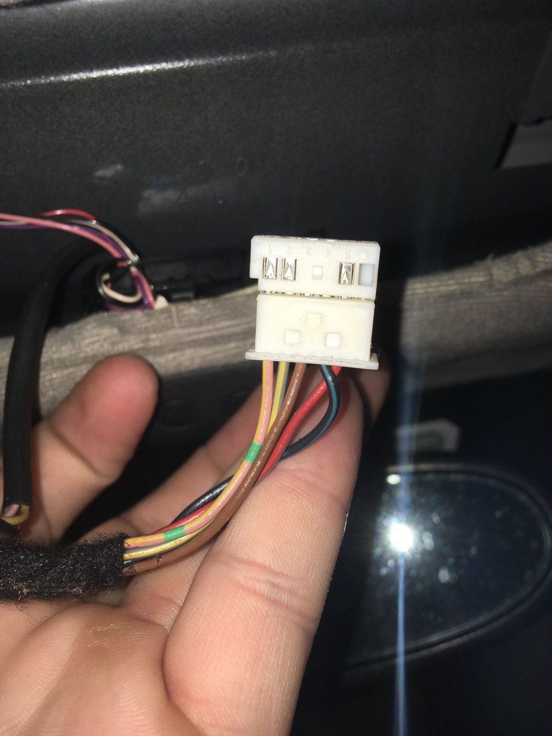

Found it but now what? I

This doesn’t look as though it is set up to disable the tpms/garage door opener... why is it still not getting power? Is this supposed to be plugged into something or is it the end of the circuit? Is there a fuse for this?

If you go to “Headliner Removal and Recovering” in the Interior section of my “Index of Crossfire ..... “ in my signature below you will see the Garage Door Opener module and the connector that goes to it. I am in Canada with two Chamberlains and I followed these instructions.
Here is the link. CLICK
Here is the garage door opener.
