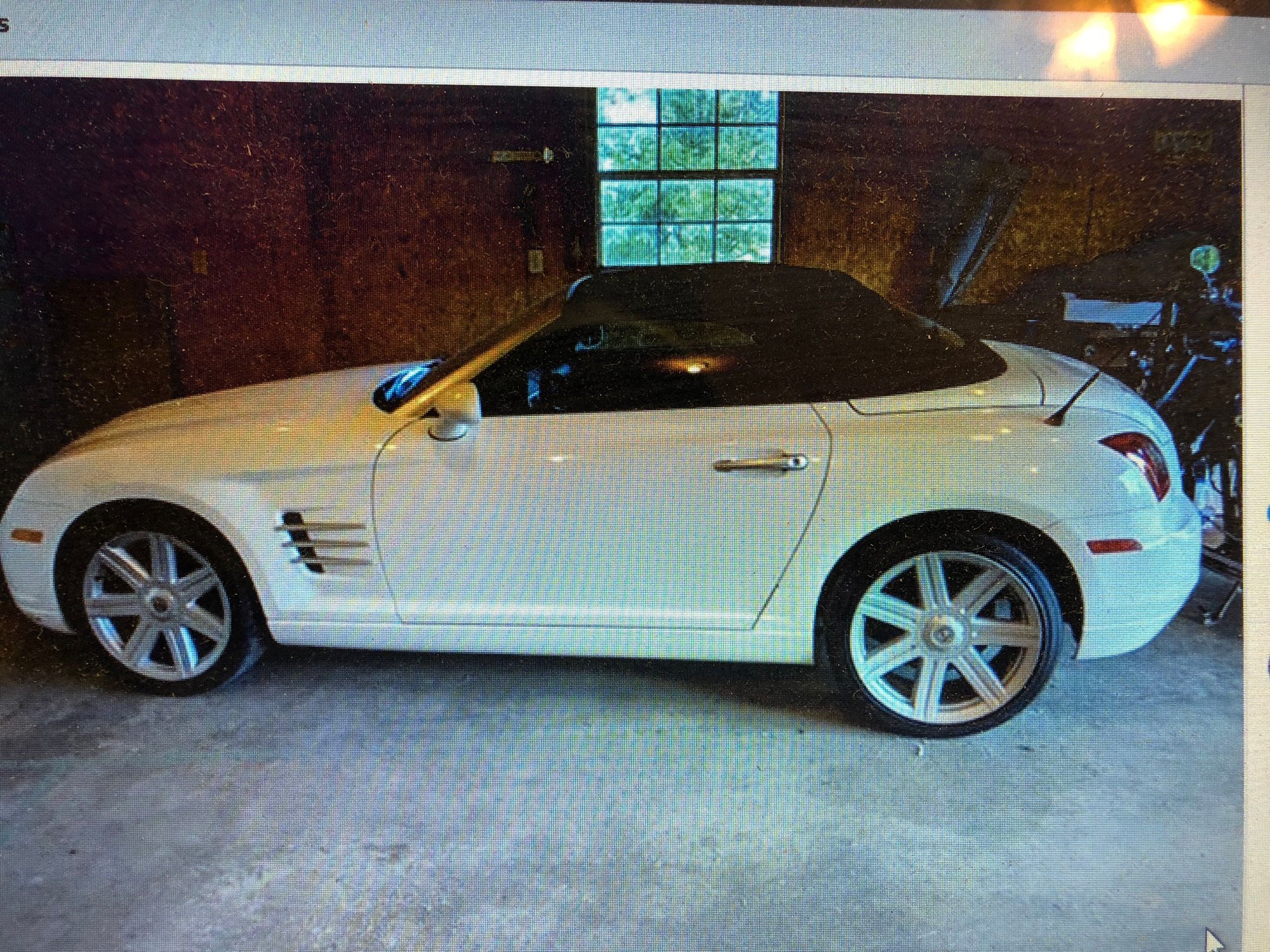

Need help on the best way to fix a back window that fell out on chrysler 2005 crossfire so many adhesive to use wanted to get it right the first time. Thanks

3M Window Weld is the preferred adhesive along with the 3M primer for same . . . I really don't know of anyone that has enjoyed long term success with trying to re-attach the rear window. Your car is 18 years old . . . as ala-xfire suggested . . . it's time to get a new top!

THANKS FOR THE HELP I WILL TRY THE 3M. THE CAR HAS BEEN GARAGE MOST OF IT LIFE WITH ONLY 50 THOUSAND MILES BESIDE THE WINDOW FALLING DOWN THE TOP LOOK TO BE IN GREAT CONDITION SO I WANTED TO TRY TO PUT BACK IN. THANKS FOR YOUR HELP

thanks for the help. i used the 3m window bond for the top and i would say this is the best to use. the only problem is getting the window align up perfect i got it close. i released the top to get the pressure off and put blankets under the glass to hold it up. what work the best was putting duct tape on the window to the top to hold it in place. after 5 days i removed the tape and glass looks to be holding in place. not sure how long it will hold but looks and holding great right now. thanks
