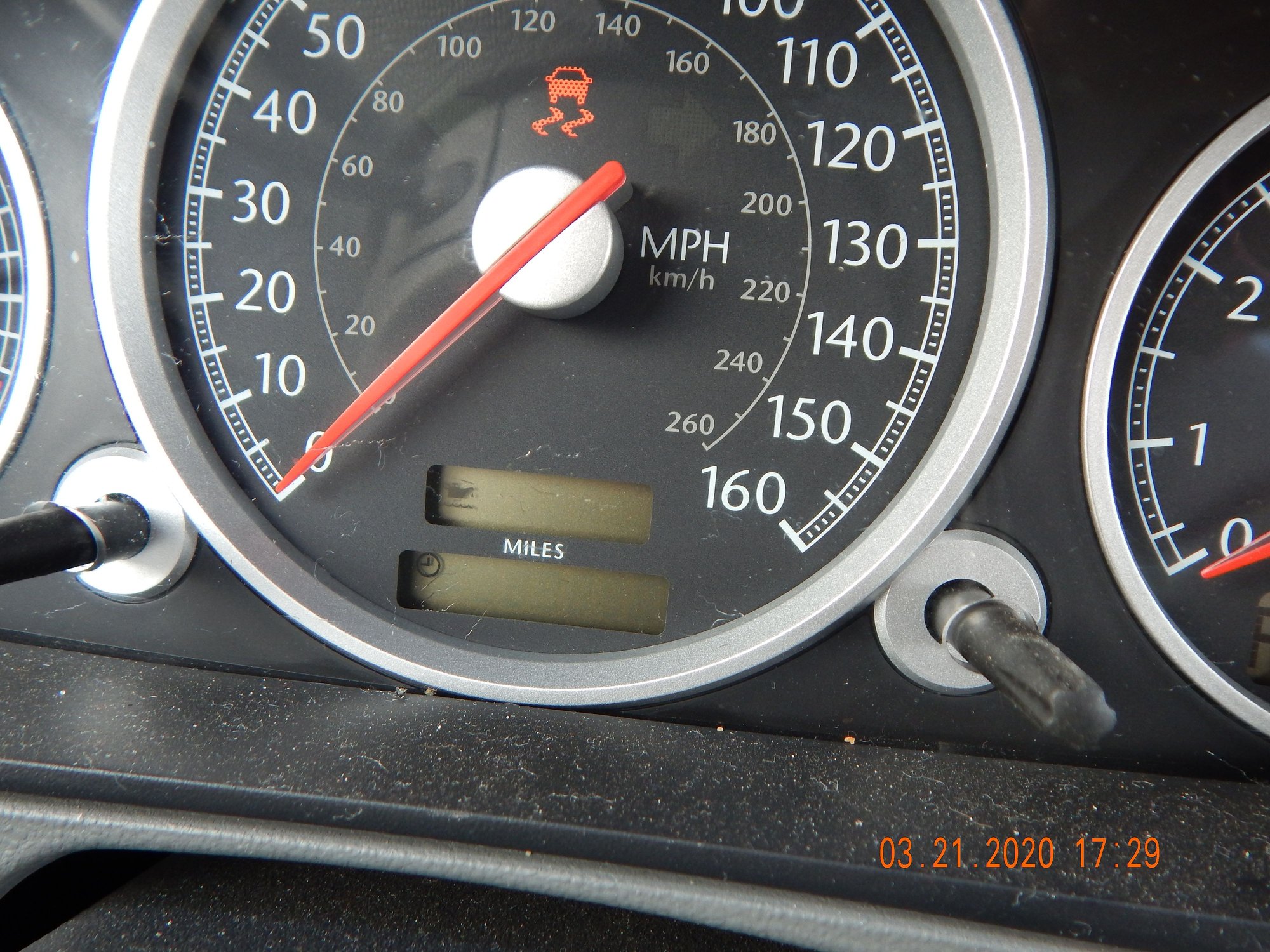

Well. Here is what I have now. When I reset, it did show 7000 miles---------- If I start the car now, it immediately goes to tripmeter miles and odometer miles. If I turn the key to run, it shows and oil can on tripmeter and a clock on odometer. I tried resetting again and again and again it still shows up the same,-------- straight to mileage if I start------- and oil can and clock, if I just turn key to " on " position. Thanks everybody

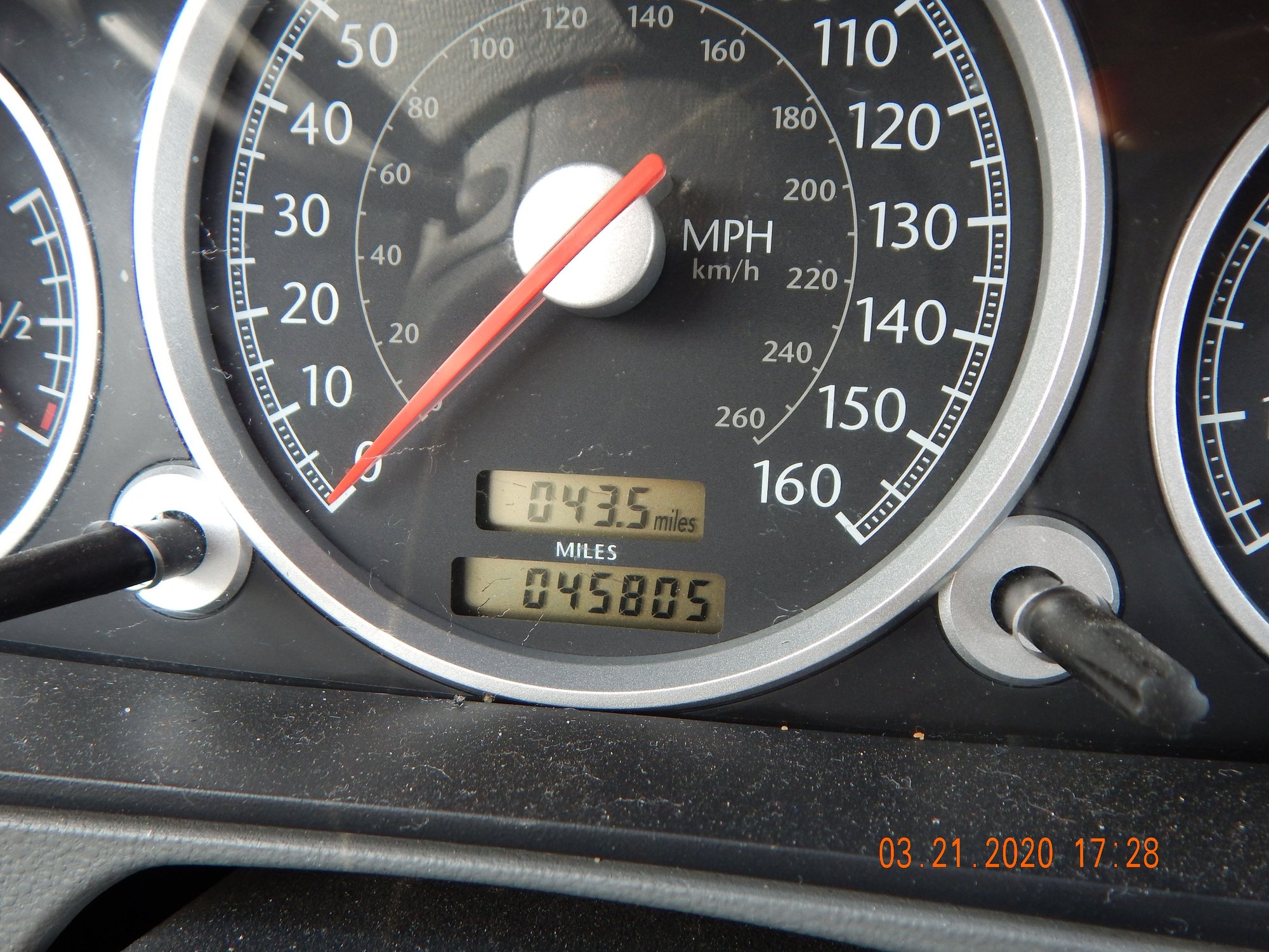

Hi, can you please take a picture of each display, and have a brief description AT EACH PICTURE so that it becomes super clear what is showing on the displays when the key is in what position? Thanks.

key in run position --this shows up for just a few seconds after initialing showing mileage ---mileage shows before and after this message
normal mileage shows when you open door, turn key on, and after starting
could not help myself
here are the pics.The normal ones of mileage only are upon entering car, and engine running. The one with the oil can and clock show for just s few seconds with the key in run position and before starting

I was asked to post some pics of what my FSS shows now, that I reset it, so here goes. The pic with the oil can in the tripmeter and the clock in the odometer shows up about 10 secs after turning ignition to run and lasts about 10 seconds before returning to mileage readings. It does not show up if I go straight to start. When I first reset the FSS, it did show 7000 miles, but since then has gone to the oil can and the clock. I can't find anything on this scenario. Bet someone out there knows
shows up only for a few seconds if key left in run position but not having been started
Normal view

The Oil Level & Clock Icons you see are associated with the onboard electronic oil level sensing system in the car. Chances are the oil level sensor has gone bad. If your oil level shows good on the dipstick, don't worry about it. See attached pages out of Owners Manual. Your FSS probably reset properly if you remember seeing the 7000 mileage indication. Electronics on these cars are a PITA!
If you haven't already, go to onehundred80's Crossfire Library thread & download a copy of the Service Manual for these cars. The 2005 version gets you info for the Coupe & Roadster; both NA & SRT-6 models.
