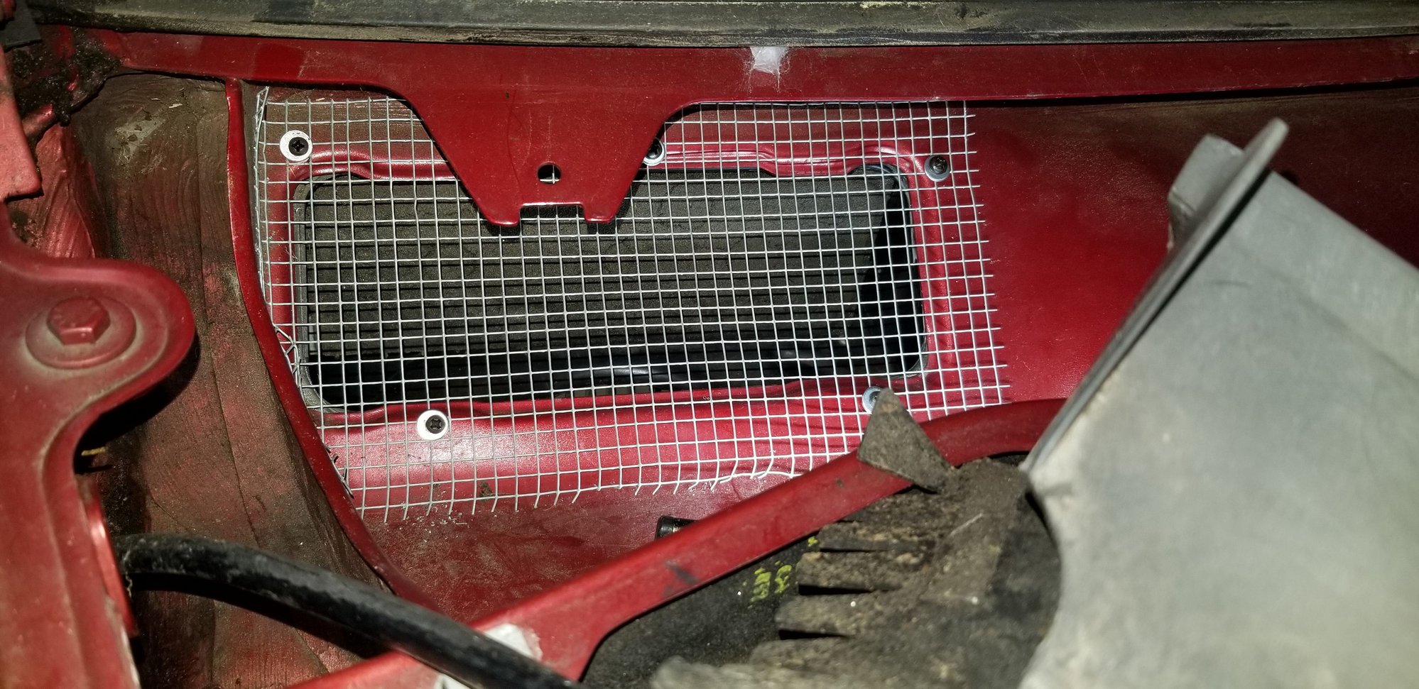

Just thought i would post this to help out. Not sure if anyone else has done this but here it is. remove the cowling at base of windshield and install this screen. at the same time you can check and clean the drains. there are four of them in total. before and after pics. Drilled a pilot hole and used real short screws and washers. This will prevent the rodants from entering in the most common area that they can get to. being that i live in upsate NY and in the country I have done this to all my vehicles and it works.

Good idea, hope you have not trapped any in the car.
I agree, time will tell for sure.
