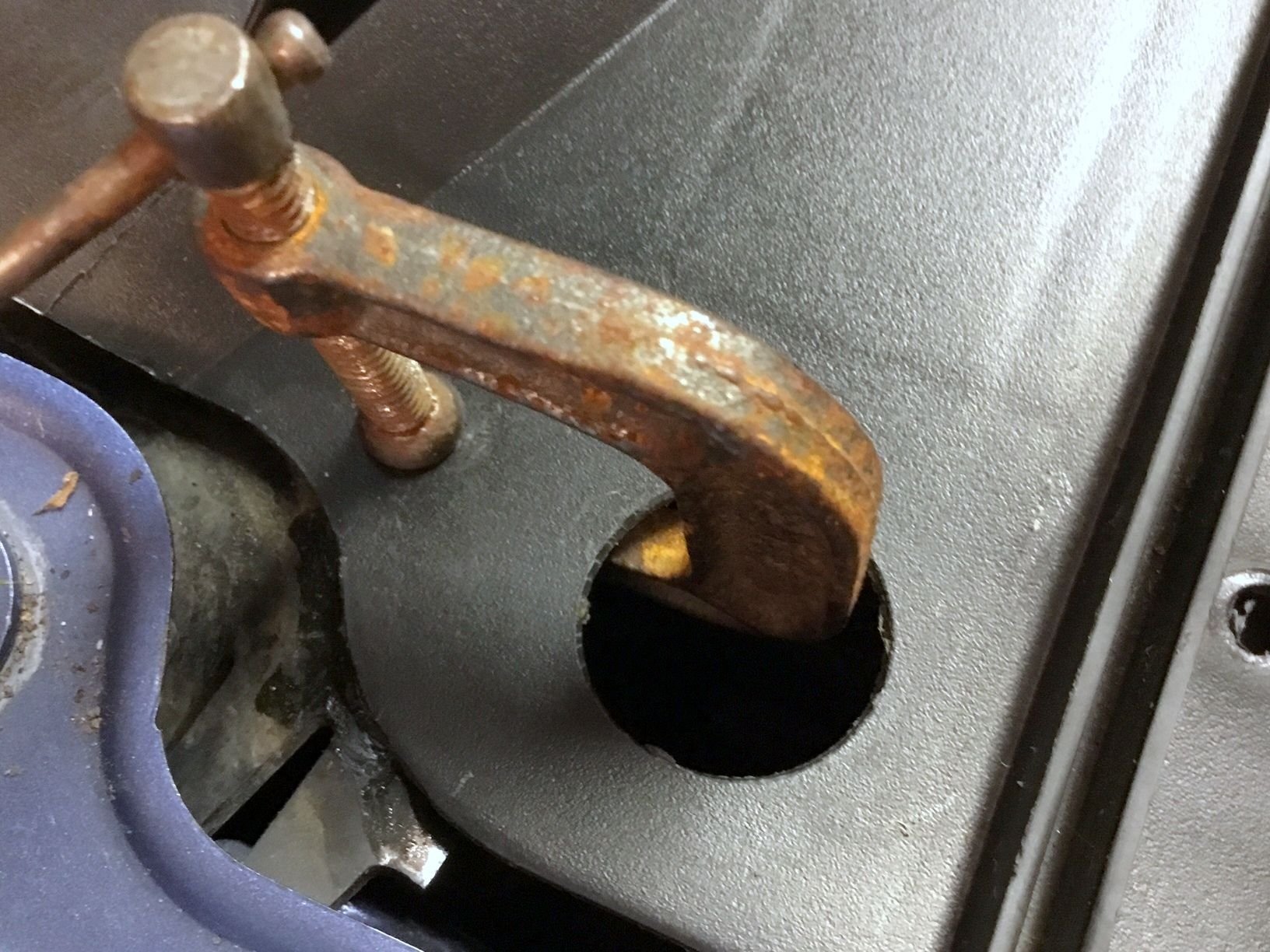

I cut a 1" hole in the cowl with a drill and a 1" diameter hole saw. Ideally the hole should be from 1" to 1/ 1/64" diameter. My hole saw cut a little to large so I had to enlarge the snap ring on the plug. By chance the head of a hammer was a little larger than the inside diameter of the snap ring. I heated the plastic just enough to force the hammer head into the ring. I let it harden up and it fit perfectly, so do a test on the hole size the hole saw cuts.
Under the 1/16" thick plastic I found the end of the rubber from which the 'fingers' are made. The hole should have its centre 1" from the side edge and 7/8" from the rear edge of the hood seal channel. I made mine 1" from the rear edge which gave me a slight problem with the cut rubber edge being too close to the hole. To get better access to the top and bottom faces of the cowl I removed the four T-25 screws and cut the plastic cable tie near the third screw.
Now I cut the rubber off with scissors flush to the forward edge of the forward finger, I cut right the way across the rubber flap. What you want is for the rubber to be just clear of the back of the installed plug.
With the rubber cut it needs to be cleaned of the contact cement on it and the back of the cowl, I used contact cement cleaner. I applied contact cement to both faces and let them become tacky before I pressed them together. I used a small clamp to hold the face together and pressed them together around the edges with my fingers.
