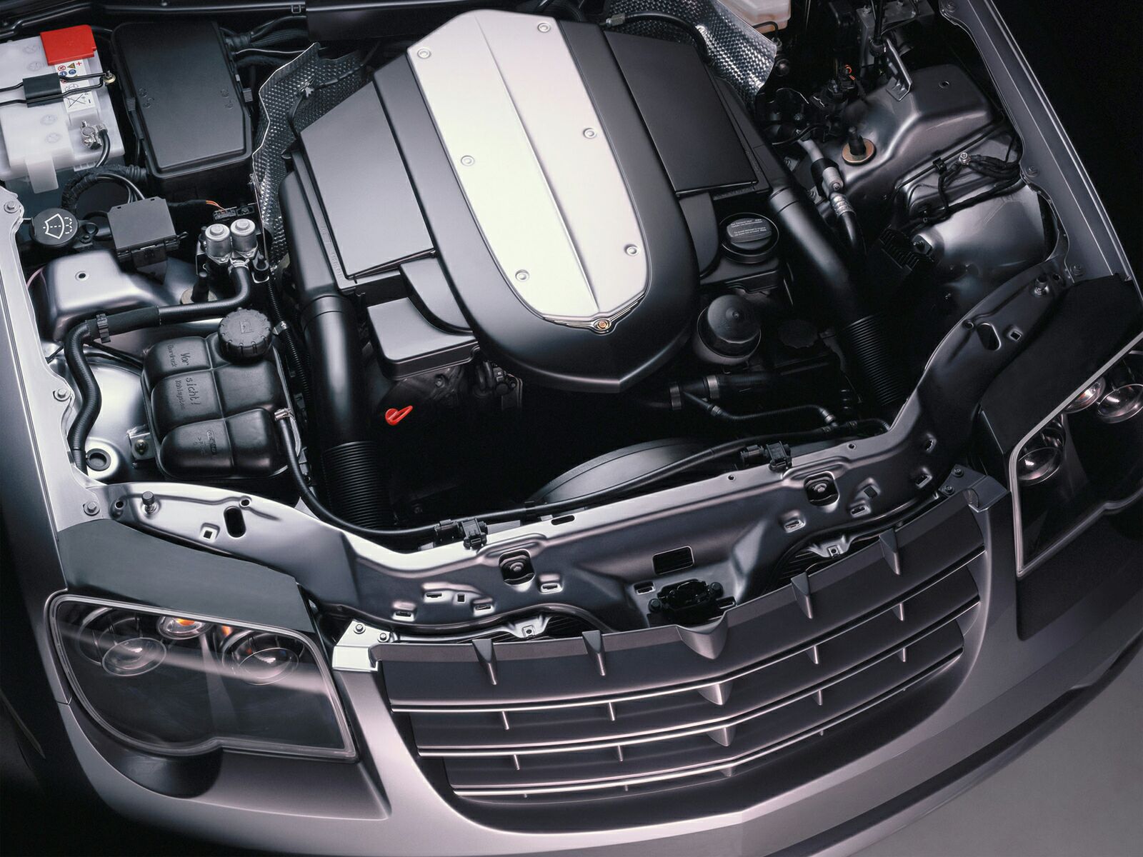

If he flipped the picture then the original engine is a complete reverse of what we have, basically the engine would have a mirror image of our serpentine belt layout and all that entails.
Good point. Then that must be a picture of an engine in a LH drive car they posted without thinking anyone would notice ........

Yes, I Agree it is not a picture of the engine bay on the car that is advertised, infact its not even a black one, look at the suspension turrets looks to be SSB to me, now I know this is the best colour but is one step to far to try to pass it off as your own vehicle

I think it is a stock photo that was put out here when the Crossfire came out. That engine cover is not standard here and is for a pre-production model I'm guessing.
I have just found another picture with that air box in it. It was in the early advertising literature.
