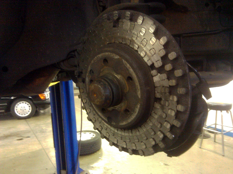

You know you have a little trouble when your rotors look like this.
How do discs EVER get into this state!
OMG....how does one continue to drive this vehicle when the warnings signs must have been so obvious to a potential problem? Unbelievable.
Old Feb 8, 2014 | 09:33 AM
Default Re: Front disc wear
Can you just imagine the NOISE that must have been making ?????
Not really unbelievable, it was a woman. Sorry ladies, just joking.
Like...."Honey there's a noise coming from the front of the car".......
