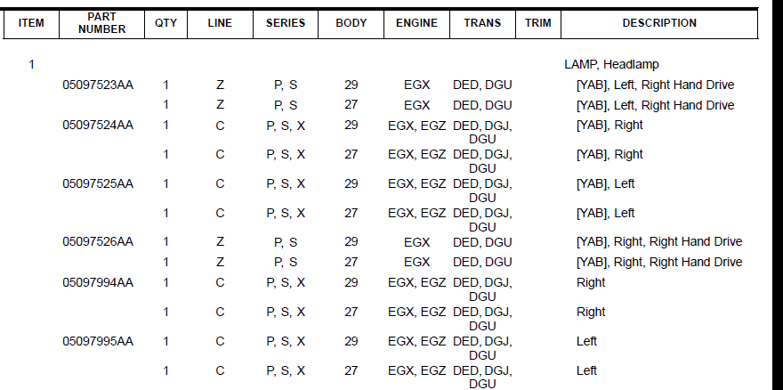

Hi everyone can anyone tell me if it’s possible to adjust headlights from rhd to lhd on a 2007 Chrysler crossfire roadster.....???? I’m importing one to Spain next week

Probably not, as the assemblies for LH & RH have different part numbers :

Thanks if that’s the case any idea where I can buy after market lhd headlight assembly from???

There is no such thing as aftermarket headlights for a Crossfire, old dealer stock or used car parts are the only options, either way it's a bunch of $$$$$
( also, used units are somewhat rare, as most collisions are front end on our cars for some reason )
