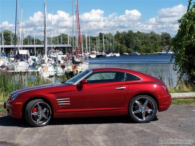

https://www.crossfireforum.org/galle...740_Small_.JPG
heres a pic of a 19f 20R

nice car! I have been looking at those, but it kinda appears they stand proud of the fender lips, is that the case? I ask bc I'm lowered 1.4"

The fronts are 8 1/2" X 19" with 235X35's. The rims are 35 mm offset just like stock and to clear the upper nut, I had to use 10 mm hub-centric spacers. A thinner tire would probably work OK for you.
The rears are inside a bit, 35 mm rims and 22 offset stock. I used 15 mm spacers there to make it the same. I could have gone another 10 mm, and it would look better. As it is, on full suspension compression (hit a good bump at speed), the rear tires hit at the top inside. I would love to lower mine, and other forum members have suggested it, but both my wife and I are not small. I guess I'm a chicken?
