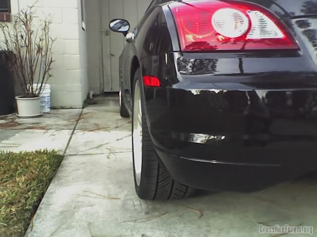

Not the greatest shot, but 295/30-19's none the less, Bridgestone Pole Positions. Picture doesn't do "the look" justice.
