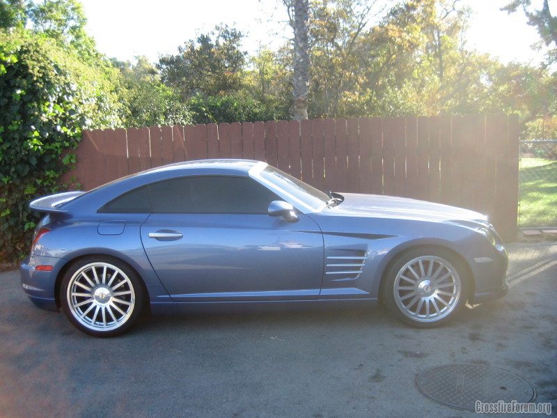

I went for a test drive and the car feels like it did stock or perhaps a bit firmer. I have some cord showing on a few of the tires so I wont be racing until the new ones get here. It could take a couple more weeks because I chose the cheapest shipping method. Here are the pics I just took in the basement. (work space) I may have to raise the rear a bit.
Les

sorry to hear about the lost nut. so did it level out nice with the fronts done now? i can not tell where the pics are noisy

The back looks good. The front is still too high for my taste. But, who cares what I like right?

The front is higher than I want it but I can't go lower without rubbing. I think the back will need to be raised a bit to look even. I'm going to wait a while to see if the car settles a bit more or not.
Les
Les
It's good to hear you got it all back together. Next time will be a charm.
IMO - I think the back wheels looks great and the fronts need to drop just a touch more.

I took some new pictures today to show the drop. The front isn't rubbing so I'm going to leave it alone for now even if it would look better a bit lower.
Les

It looks good Les, but I think the guys are right.... it would look even better with the front down a little more with the back where it is....

Looks good, but like 1/2 more in the front and you're golden.
