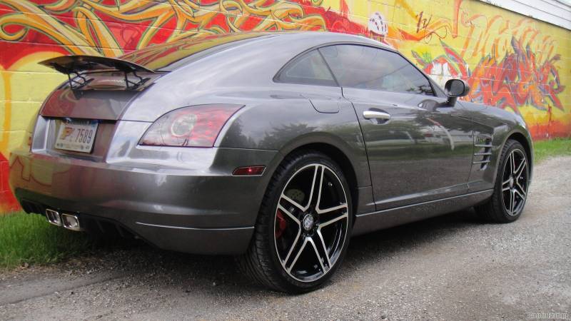

The last one was mean in its own way, but this one is much more go than show and still looks good IMHO. Your parts will aid this endeavor greatly, thanks again.
Please tell me you got Ruby (haha that never gets old) and Paul involved in modifying this car.
Looks great.

John,
The ride is looking mighty fine. Great work!

Looks fantastic John! Love the very stealthy look it has.
I do have a question as to why you went with a 18/20 stagger? Was it merely for aesthetics? I can't imagine that 20" wheels are the lightest things, and you mentioned auto-crossing the car.
Love the choice on wheels tho -- a timeless, clean look.

looks great,,,not that much weight gain,, did you get gray window tint to cover the side lights ,,or all the outside lights ? they look darker but if you use the gray tint ,it will like thik they aren't there ,,until u turn them on o fcourse. jim

I don't think the old girl was too rough on the eyes....
Found your thread!!
First question is... what grille is that on this baby ^^
Second question... was it hard to/expensive to install the SLK 32 AMG brakes?
Thanks,
Eric Henderson
It was for aesthetics, mostly, but also due to the fact that it was very difficult for me to find anyone willing to 'split' a set of wheels, and the people who were willing to do it offered no warranty. After 6 months, I found the wheels I wanted, a 2 year warranty (structure and finish), and he was willing to break up 2 sets for me, but all it was available in was 18/20. I also wanted to do something a little differently as most go with a 18/19 or 19/20, you know me, always have to be different .
I did not get a chance to weigh them, but they are lighter than the OEM wheels + tires by several pounds, even the 20s. I will weigh them at some point, but wanted them ON the car LOL.
Thanks Jim. I took out every lense in my car and wet sanded 5-7 times and sprayed on something like 7 coats of lightly tinted clear until I got the desired shade. I also did a flat black strip around the top of the tails to set them off. They not only look nice, but the finish is so amazing - smooth as glass and just as reflective as the cars freshly polished paint....

Grille is an original one off from a friend If he wants to make another one, I will let him chime in.
The SLK32 brakes were a DIRECT swap, literally everything swapped right over the factory hardware with the exception of the rear bolts being too short and having to slightly bend the dust shield. Search on brake upgrades and you will find a recent thread where Dave and I go over everything in depth. Expensive? It is a relative term, but I only have AMG brakes because I autoX and got a smokin deal on them....
I understand all too well about the refusal to break up sets... I'd be curious to see the weights of the rears. I ended up losing 5 pounds per corner on fron, and six pounds each on rear.
Steve can verify this, but I'm almost certain the SRT-6 brakes and SLK32 brakes are identical... 330mm hats with two-piece calipers. Not too bad on cost. The $$$ is in C32 aluminum calipers, and the optional two-piece rotors from Racing-Brake

They are identicle to the SRT package, and IMHO the C32 on a limited is overkill - on an SRT makes sense with the extra weight (especially the roadster). A nicely upgraded brake setup like I had on my black coupe is great, OEM size D/S rotors, T/K pads, Dot5 and SS lines. That would take some abuse, now the SLK32 setup is insane on a car barely tipping 3K. A guy who autoXs with us in a M Coupe (highly modified) said my car stops quite a bit better than his (3600lbs) that brought a smile to my face
John have you done anything with the brakes yet?
I am trying (desperately) to get on your level with the suspension (pun intended )
Old May 10, 2011 | 06:02 PM
JHM2K's Avatar
Posts: 6,349
From: Murfreesboro, TN
Default Re: Upgrades
All I've done on brakes so far is in the sig... Akebono pads and the ATE super-blue fluid... DOT5 is a bit iffy in some applications... DOT4 should be all you need. FWIW, the only cars that we fill with DOT5 at Nissan Motorsports are the full-blown track queens... If you cook DOT4 in a street car, you're relying on the middle pedal too much.
As for the suspension, the cut AMG springs will bring a smile to your face. I still wake up at night sometimes wondering what life would be like with Vogtland springs, but then I am quickly reminded that the SRT/AMG springs are indeed competent.
I will be going with the C32 setup eventually, simply for weight savings and aesthetics. If it stops too suddenly, I won't press as hard next time.
The racing-brake rotors (340mm only) are 17 pounds... the 330mm rotors are 26 pounds each (300mm rotors are 25#). Couple that with my new wheels and that's a 13 pound savings per corner in rotational mass on the front end. The aluminum C32 calipers are ~30% lighter than comparable steel two-piece ones... a nice drop in unsprung weight. Hello curves

Thanks guys, here are a few more shots....
Oh yeah, and the next batch of parts that I am going to paint is definitely going to include the doorhandles (last silver exterior accent left )
LOL...same here, Ive been driving around for over a week with tape over the holes in the doors and the handles primed and ready to paint in the trunk. Your car looks slick BTW
